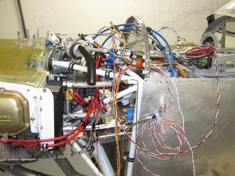

Any users of either Setrab or Mocal oil coolers on RV-4 0-320 ?
What size did you find was most effective ?
Standard or heavy duty?
Installation pictures would be useful if available.

7 row mocal on an O-360 in a DR107 has worked for me for 4 years. Definitely heavy duty due to start up oil pressure surges. Will post a link to pics tomorrow.

See this page - might not work on an RV-4 due to cowl cheeks.
So far no cracks in 4 years - plenty of hard aeros.

I have a new one if you need it. Comes with the 90 deg fittings. I may even have the brackets I made. I did some upgrades to my engine (more horse power) and placed a bigger oil cooler on the plane just in case. I also installed an oil cooler shutter. The engine I have previously ran with the same part number oil cooler for over 1200 hrs and never had a problem. It was rated for 160 hp. Please disregard the wires. My plane does not look like that any more.
