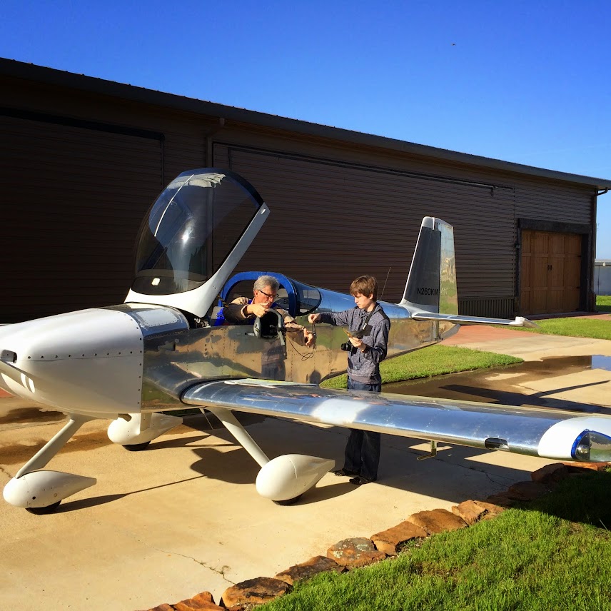

Now why on Earth would my RV-7A project, one that never traveled faster than what Tony Partain's truck could carry it, have a bug splat on its wing leading edge?
Because RV-7A N260KM flew her maiden flight yesterday! Actually, it was a 2-hop. The first flight was very brief, because I had no airspeed and because my SkyView EMS triggered a high CHT warning for my #3 cylinder. I climbed and turned directly into the downwind and landed using GPS ground speed.
I figured out that I hadn't loaded the correct CHT scales into the SkyView EMS configuration, and that I had crossed my pitot and AOA lines , I corrected those and launched again. This time, everything was picture perfect. No roll/pitch/yaw problems, no heavy wing, no cautions or warnings...just one really happy and eager airplane.
Prebriefing the flight. Blake and Monica Graham (left) flew chase in their RV-7. Tony Malley (my brother-in-law, to my right) ran the ground crew. I wore my USAF Nomex because it was, after all, an EAB first flight.
My son Houston helping me get strapped in.
Ready for engine start.
Run-ups complete. Blake and Monica are ready on the right.
She wants to fly!
She floated a bit on landing, no thanks to my extra few knots for Kelli and the boys.
Need I say more? My face still hurts from the non-stop RV grin.
