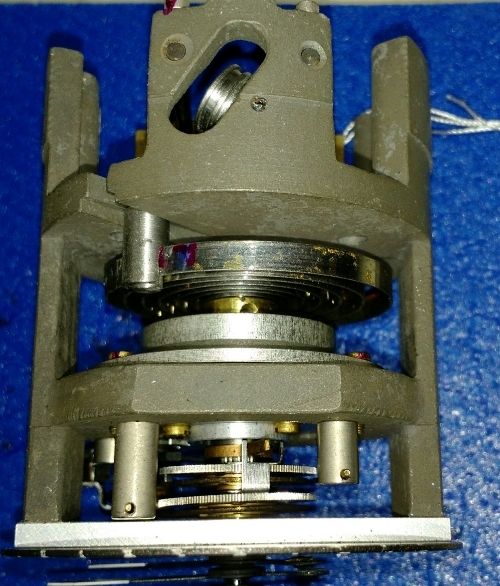

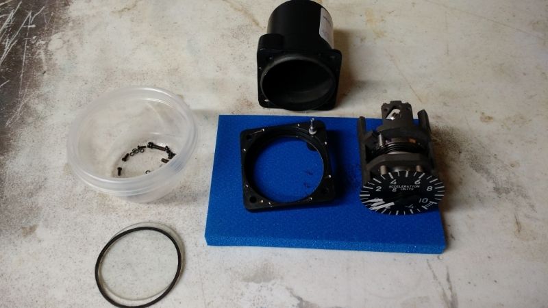

My Falcon g-meter was installed in 2005 and has never worked. I really didn't care much because I had a G-meter on my Dynon D10A display, anyway. But now I've decided to try to fix it. After discovering this thread, I opened up the G-meter. It looks like this when in pieces:
Caution: There is a small brass screw in the back that I think is an tamper-indicator, or seal of some type. It was covered in wax or something. I didn't know it was there and broke it when taking it apart. I don't think I care, since I'm not doing a certified repair.

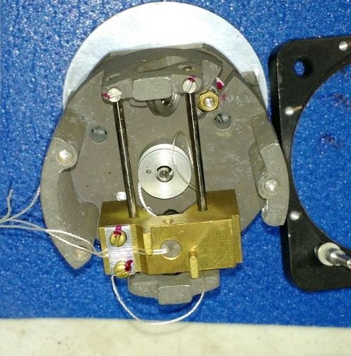

As mentioned before, the G-meter works with a spring, a weight, and some strings that tie everything together. The internals of my G-meter look like the following.
Note that the strings are all messed up - they are just a tangled mess. The good news is that the string is not broken. The bad news is that I don't know how to route the strings back on the pulleys correctly. So does anyone know how the strings are supposed to go inside there? Does anyone have a picture?

Hello Jordan,
Gee, I wish I would have taken some pictures. I don't remember the exact routing of the string. I do remember it being wrapped around the pulley several times so that when the weight moved, the pulley turned with it. I don't remember what the other end of the string was attached to. I wish I could be of more help.
If it's any consolation, my g-meter has worked perfectly since I adjusted it.
