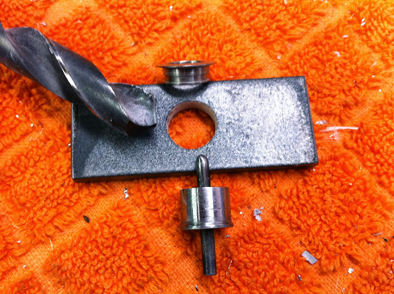

First there are these little inserts from SB to allow using a cleco for the fit up process. I could not get them in position, so I made some little plates and used 4-40 flat head screws for the process.
Then, came elongated holes. After I was satisfied with the cowl location, each cleco in the SB location was removed and an arrow used to indicate which side of the hole was to be used.
Then came to drilling. I made a drill guide and an alignment plug. The plug was plug w/pin was forced with the arrow's aid then two vice-grip c-clamps were used to hold the guide in position. The holes were drilled with a hand held 1/2 drill to 1/64" size smaller than desired. A dowel wrapped with sandpaper quickly fitted each hole to the SB ferrule.

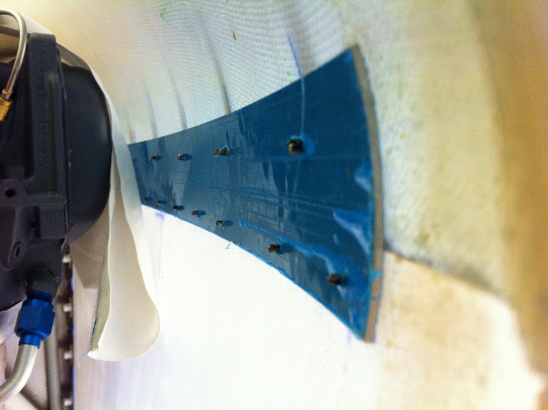

Here is the split rail installed. An inside view

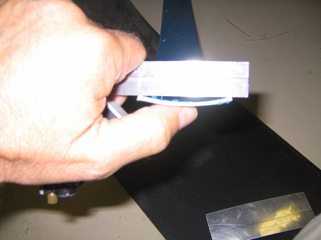

A quick look at the contour gage at work. I marked the split line on the gage to know where to locate the gage against the part. The copper cleco is the SB location station. There was surprising change from the one to another. Only the first 15 inches inches was curved on the vertical.
