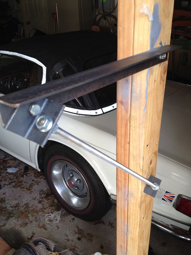

How much distance between the wings is needed to work comfortably? And how high should the fwd spar be above the floor for 6' builder?
I'm short, 5' 6" with short arms. My wing jigs were built so the spar was 4' off the ground and 3' between the wings. Worked pretty well. Only a few times a creeper was used to work rivets on the rear spar. Height was pretty good for riveting the bottom skins. Much higher or lower and my shop stool would have been useless. I have two Home Depot rolling shop stools. They adjust like an office chair. Very handy.

Originally Posted by WVM View Post
Other option I am considering is this design in wood:
Wing stand SmittysRV
Thanks!
Consider using threaded rod to support the spar bracket. This way you can "dial" it in dead level.
N677AT reserved
Absolutely. wouldn't do it any other way. In fact, I have a complete set of AL angles and threaded rods, nuts, brackets, etc. if anyone needs them. They're even notched for the spar flange. The guy who started my -7 made them, they're quite nice.
