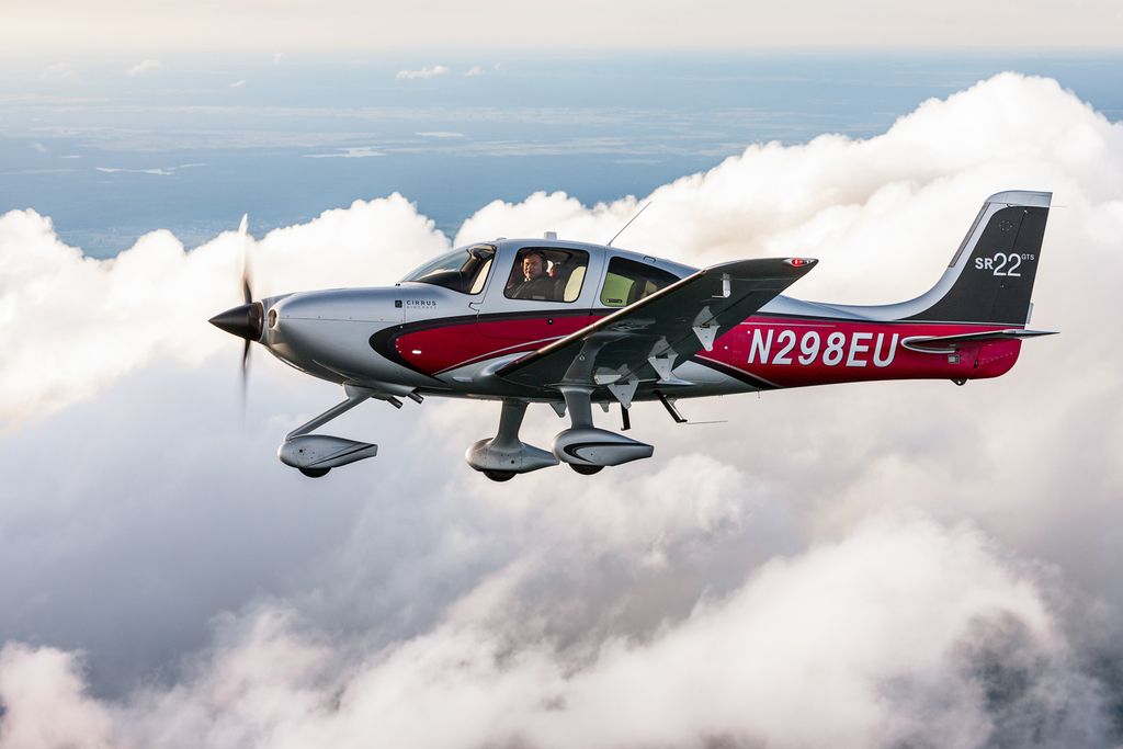

Originally Posted by Aero_Octaveus View Post
(Fiberglass planes can only be primarily white)
Is this accurate? Isn't the Cirrus fiberglass? Perhaps they use some sort of process - always thought they were painted. I've always really liked their schemes on the newer planes.

Originally Posted by Greg Arehart View Post
Why is this?
Greg
Temperatures. If glass airplanes get hot, the structure weakens. So you paint them white so they stay cooler sitting out on the ramp in a sunny/warm climate. There is a very large temperature difference between a white airplane and a dark airplane in those circumstances.
