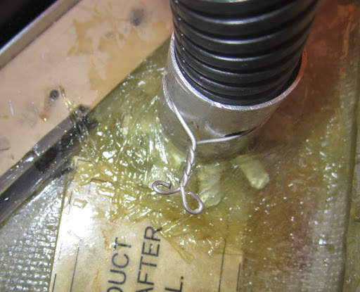

I left my voltage regulator in the original location but attached the blast tube to the radiator duct. The fitting is made from scrap aluminum tube. Slits were cut in the end of the tube to make the splayed legs. Originally I used a rubber "O" ring instead of the safety wire, but the "O" ring broke. The safety wire is not easy to work with without pliers.

Did you let the tube stick out a bit and cut it off in a 45 degree angle to direct air into the tube?
No, the tube does not protrude into the air duct. The diameter of the hole drilled into the air duct is the same as the inside diameter of the tube. So it relies on pressure differential for air flow. I made that modification 2 years ago. The regulator has not failed . . . yet.
I thought of another way to hold the black blast tube inside of the aluminum fitting. Strike the outside of the aluminum with a punch to make dimples protrude on the inside. When inserting the blast tube, it will have to be forced past the dimples. Thus no tools or fasteners will be needed to insert or remove the blast tube.
