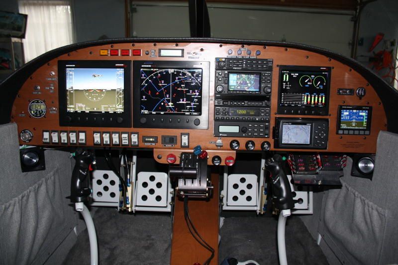

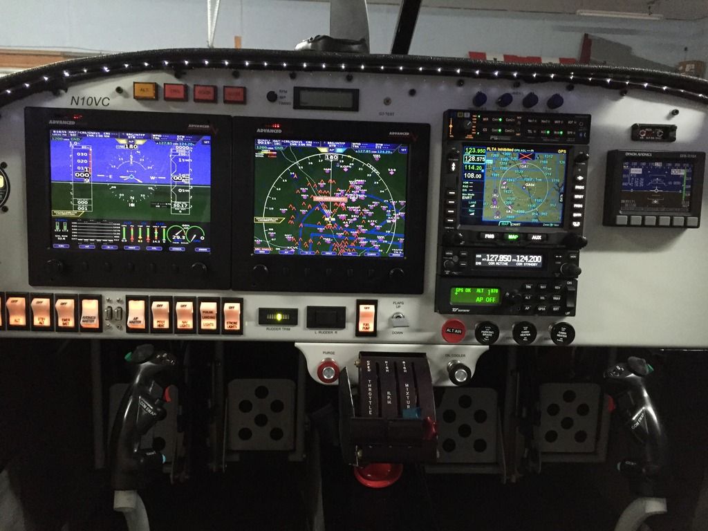

Well, I've been burning the candle at both ends lately and hopefully I'm almost done. I finally got power on the new panel upgrade I've been working on for our own RV-10, and I am really pleased with it. Here's a before and after picture, and here are the highlights:
  • removed the 3400 EM and moved the D-10 into a better field of view
  • installed engine board in 5400
  • replaced Garmin 430 with Avidyne 540
  • removed 330 transponder and installed AFS remote ES transponder and ADSB box
  • replaced SL-40 with Garmin 225 (my older eyes like bigger, brighter digits)
I really like the Avidyne. You can Hold anywhere with just a couple of entries. And Rob's new Software for the AFS stuff now has WIFI and downloading Foreflight flight plans are instantaneous. Really cool.
So far everything is working on the ground, including traffic and weather.
Carol is working on the interior, too, so I hope to fly it soon.
Before:
After:

Cool, Must be the first Bendix unit in an RV. Been seeing those in magazines and they Look like a real nice device.

It is the new Avidyne IFD540
http://www.avidyne.com/
Since we introduced the IFD540 as an option in the Advanced Quick Panels they have been very popular, all of the current IFR panels we are working on have an IFD540.

Vic can't wait to see how you like the Avidyne. The panel looks great

First flight was tonight. So far it is really impressive. Very powerful box.

Default Push-pull knobs
Vic,
Where did you source the purge and oil cooler controls from?
Thanks.

What a great job Vic, looks very professional. just a quickie, the switches, where did you source them?

The cable controls were from Aircraft Spruce and the switches were from Aerotronics about 5 years ago. I think they carry a different style now so I reused the ones I had.

The switches look like Honeywell AML series----------Aerotronics is where I got mine
