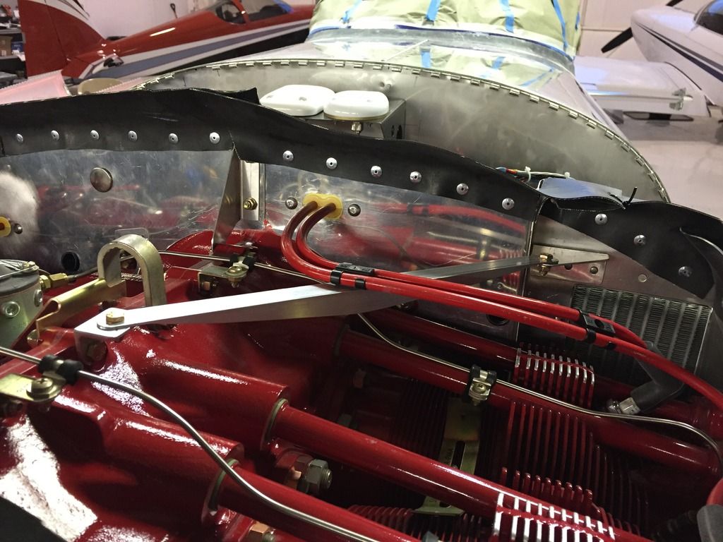

Paul, you're probably way ahead of me on this already but most of the RVers on my field (KBJC) have added a brace from the engine to the rear baffle. This has eliminated the cracking problems around the oil cooler, at least for now.....
Here's a pic of mine
Bob
