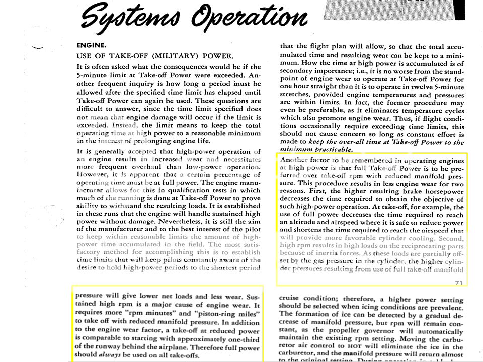

I fly with the local CAF squadron, and we had a similar discussion about reduced power takeoffs with a R-1340 engine. Here's what we found in the T-6G Flight Handbook. (I highlighted the relevant paragraphs.)

Military power - all the engines referred to here supercharged/turbocharged/turbocompounded or some combination. Also they are designed for high altitude, which means the turbo machinery and matches provide much more boost at ground levels than at altitude. It is easy to over boost even with 130 octane. We (mostly) are using normally aspirated engines, so much of the discussion does not apply.
Even for our NA engines, it takes about 10 min (to 15min) to thermally saturate at steady state. 5 min on TO would still allow the temperatures of pistons/top ring grooves and barrel at top ring positions to be in range and not at peaks. I think time to 1000'agl is easily within 1.0 min and should have little effect on the deleterious results of sustained steady state operation at high power/temperatures. Like - top ring groove coking, oil plating on wrist pin, marginal oil film at top ring turnaround, lowered piston fatigue strength due to elevated temps, and higher oil to bearing temperatures, detonation, and more.
Just my opinion, though.

The quote from the T-6 manual that stands out to me is this:
In addition to the engine wear factor, a takeoff at reduced power is comparable to starting with approximately one third of the runway behind the airplane. Therefore full power should always be used on all take-offs.
This makes me think of:
Things which do you no good in aviation: Altitude above you. Runway behind you. Fuel in the truck. A navigator. Half a second ago.
Approach plates in the car. The airspeed you don't have.
