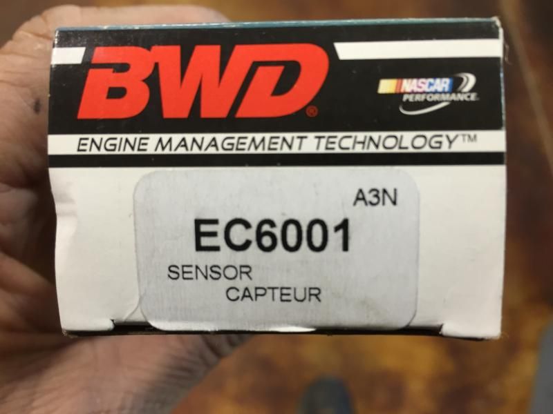

Starting my condition inspection this weekend, and 1 thing on the list is replace the MAP sensor. I have a Dynon and can get one from them...but I seem to recall a post saying GM sensor is the same and locally available.
So anyone have a part number or other info about a direct swap vs the Dynon part?

12247571

Some more numbers that can help:
GM Part #16254539
Napa PN: CRB21963
Autozone P/N: Wells SU129
Shucks/Kragen/Checker/AC Delco #213-361
Make sure you get it via part number, not just looks. There are 3 parts that look identical, but only one works.

Old 02-28-2015, 11:01 AM
hydroguy2's Avatar
Join Date: Sep 2006
Location: Townsend, Montana
Posts: 3,179
Well, that was chore for no gain. None of the numbers above worked for me at the local autoparts shops....except the number 12247571. I was able to cross this number over at O'Rielly autoparts to the below sensor.
The bad news is....the MAP reading on my Dynon on the ground is exactly the same. Haven't flown yet, but makes me wonder what's next.
I replaced the Dynon sensor because it appeared I had a 0.3-0.4 error.

Brian,
I see you are in Montana, which is not at sea level. The MAP and BARO setting should not match unless you are at 0 MSL. Are you factoring this in?
