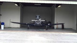

Wig Wag (MaxPulse) Whelens on the Swift. Click on the image. The video was shot in bright sunshine.
