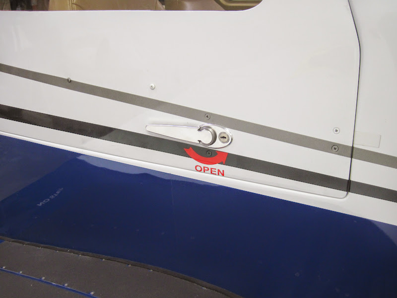

Ed,
The tongue I got with my lock from ACS is flat. I see yours is bent. Did it come like that or did you bend it that way? Did you use the ACS lock part #11-01600. The metal tongue seems pretty tough and difficult to bend.
Thanks.
Johan
Dorfie

The kit comes with a new lock arm.

The cam lock arm comes with the Aerosport kit.

I just finished the retrofit to the Aerosport handles. Pretty straightforward, I was extremely cautious since the plane was already painted!

Ed,
How did you finish the interior surface of your doors? It looks really nice in the video? Maybe a painted matte finish?

Originally Posted by digidocs View Post
Ed,
David
Thanks! I finished it with a method I stole from Geoff at Aerosport. I painted the door interiors normally for a few coats, and then for the last two coats, I turned the pressure WAY down on the gun, to where the paint just splatters out. It gives a nice textured satin finish. I'm really happy with how it turned out.
