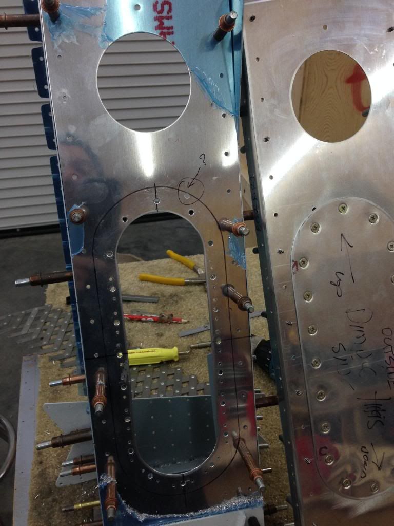

After doing my research I decided to do the "Gear Tower Mod" including the lower two holes in the F802-C R1 & L1. I noticed my access cover will partially cover a 5/32" hole adjacent to the 10th rivet up from top of the WD813-1 weldment. It's the same on both the left and right towers. My questions are:
1.) What is this for?
2.) Is it something I can move?
3.) If not, do I need to make room for it in my cover panel?
Thanks for all your help!
Tim

I think I remember this is a screw for mounting a clamp. I just made a notch for crearance.

I did not use it, but then I did not plumb the brakes or the fuel vent per the plans... You can always drill another hole to suit...

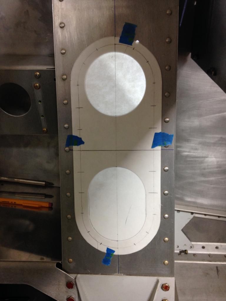

Started planning out my gear tower mod today and encountered this same issue. Did a quick scan of the plans and couldn't see why I couldn't cover the hole up but thought I would see if anybody else had encountered it before. You can see the hole just to the right of the top tape. Need to confirm it makes min edge distance with the planned hole right next to it or I might have to adjust some dimensions on my template to get the MED.

Be sure you check the clearance between the nut plates and the L chanels on the back side before you drill your screw holes!
