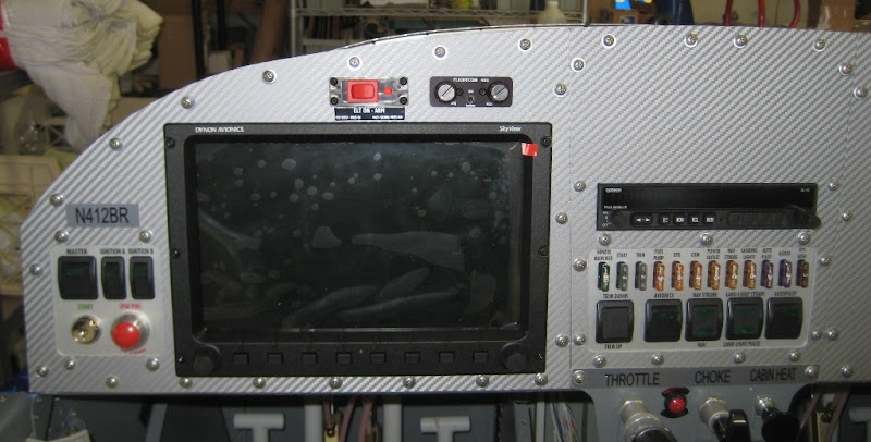

Old 01-22-2015, 08:25 AM
Bill_H's Avatar
Bill_H Bill_H is offline
Join Date: Aug 2010
Location: Marshall TX (KASL)
Posts: 1,783
I did my RV12 in silver. I went with the non-countersunk screws with silver washers - I like the look with the background. The engine control labels and N-number were made at a local trophy shop. (The screws under the engine label are countersunk.)
and another:
Bill H, RV12, N412BR "Sweetie", Skyview-equipped, KASL Marshall TX
