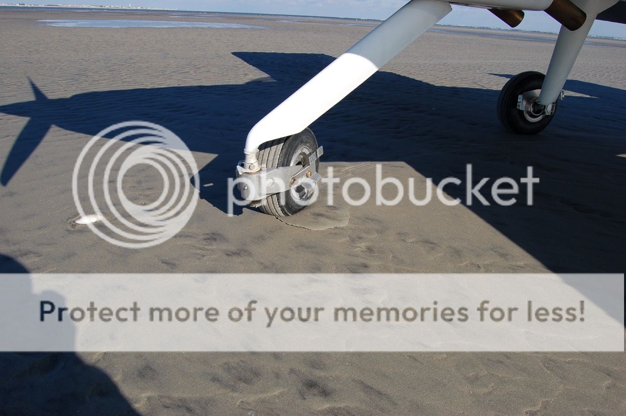

Niet they don't like nosewheel here. It digs in

The "normal" way to remove the new style fairing is with the brackets still attached to the fairing... or did the beach landing remove it for you

Ha! Didn't know that thanks Walt. Learning something every day

Ya I learned that the hard way before I even flew my airplane. I had been putting it on and off by stretching it around the bracket and accidentally cracked the wheel pant. After the repair I've never done it that way again. It is way easier just to pull the allen head bolt and slide it back. What was I thinking?
