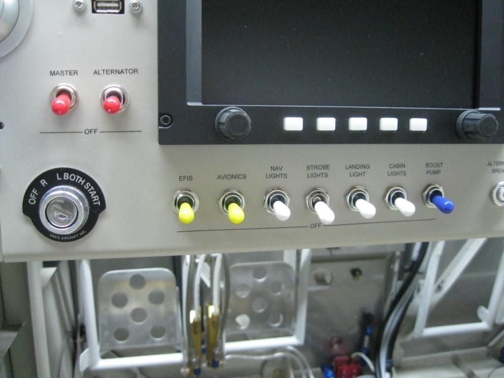

I'd add Alternator Field to the list of toggles, and put it next to Master.
Here's a pic of my switch layout. The spacing is at 1-inch intervals; too close and you risk flipping two switches at once, and labeling gets crowded in a hurry. Another option is to install switch guards for critical functions.
I preferred to mount Master & Alternator up high and out of the way, and I'm a big fan of color-coding the toggles with slip-on covers...white for lighting, red for what I consider the two primary switches, yellow for EFIS/Avionics and blue (to match the 100LL dye!) for the boost pump.
