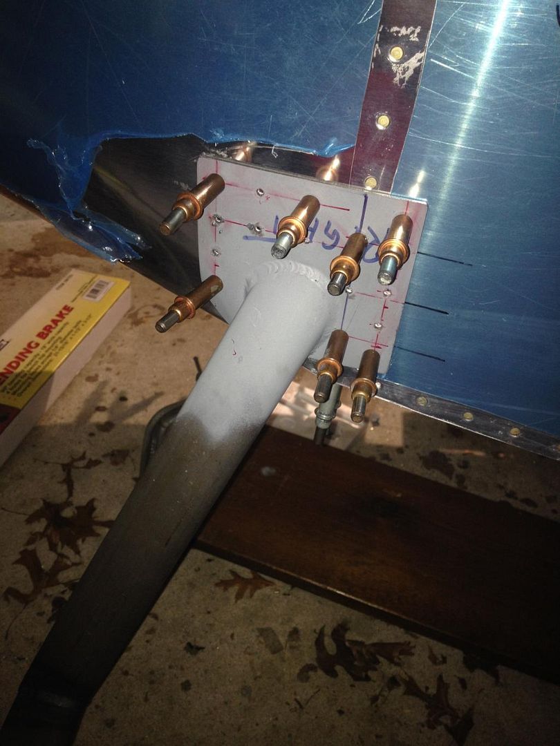

Sorry, more questions...
I just fitted and drilled the step. Has anyone put a backing plate behind the step in the inside or is that just overkill?
N677AT reserved

I would consider some modification to the steps to prevent cracking. Personally, I'm not quite there but plan to do something like weld a gusset.

Tom. Use epoxy primer on these! Also try to
Get the primer on the inside as well. Self etching
Primer out of a can will not cut it in this case.

Some guys are bolting them on, so they are simpler to replace if or when they crack. Not pretty, but.........
I can see why you'd want a backing plate inside, but so far, that doesn't seem to be the failure point of the steps.
Personally, to avoid excessive tugging on the prop, nosegear, tailhook etc.....I do a fair bit of pushing and pulling on the steps, so I'm sure I would benefit from this being beefed up a bit.
one more point, I find that the stress on the steps is MUCH less if I use a low stool/box on the ground when possible.
If you watch the average guy mount his RV, you'll see a pretty good jolt to the step when you launch your weight from ground level up to the wingwalk. Starting from an 8" step, so you are only lifting your weight another 12" or so, really reduces this ''G'-load!
Just my $.02
Perry Y.
Just my $.02
I instruct all my passengers to exit and step off the wing backward. It is much more controlled that way as stepping forward one simply falls on the step and it is much bigger impact. It?s been 500 hours and I am keeping my fingers cross, let?s hope I have not jinx it here.

I installed backing plates for my steps when I installed them. I also used proseal on both mating surfaces.

Thanks everyone. Has anyone used countersunk rivets?
I was advised against it by Vans.

I have done my step to be removable. So it will be easy to remove it if I want to weld it in the futur or put a new one if they break. See my Kitlog for more info :

As mentioned, not a failure point. I think it is overkill.
I used counter sunk rivets but I also used proseal between the step and skin. Have seen a lot of installations at Kosh with rust running down the skin under the step. Prime and paint the step mounting surface first.
I think bolting the step on is admitting failure. However, with the failure rates experianced, not a bad idea. If I was mounting the step today, I would make the modifications to the tube/plate weld area. This is where all the failures have occured. Then mount it exactly the way I did.
So far, two years and about 150 hrs. Not long enough to tell if it is going to fall off or not!
