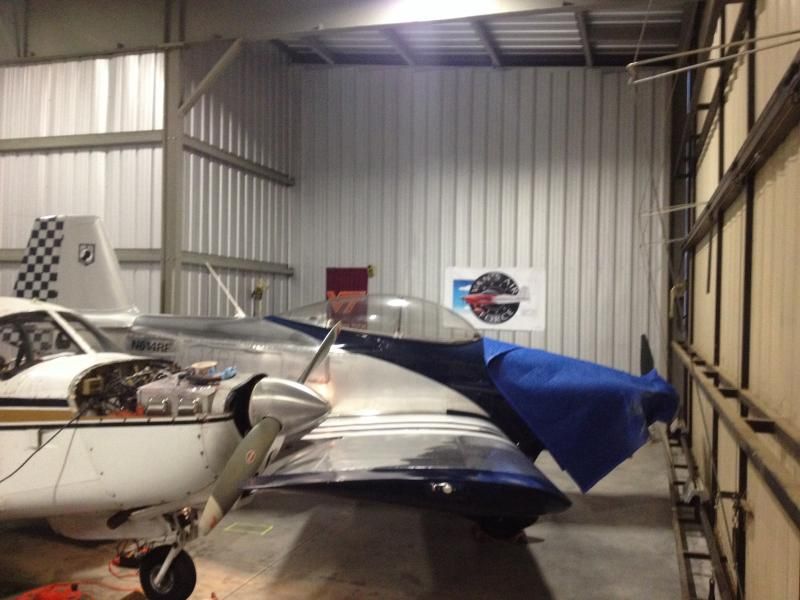

Default Not fancy...
Fuse of RV rests on blankets and insulation atop Mooney wing. Tight fit, but it works!
