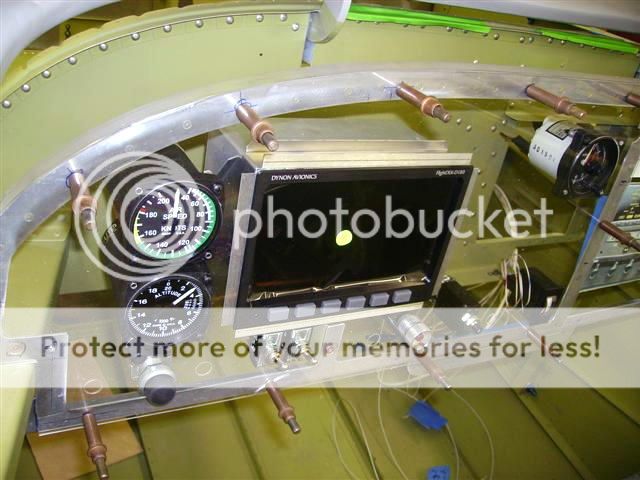

Were I to do a panel ( a definite possibility depending upon what the a/c I get has) I think I'd opt for a plexiglass mock up.
Haha I was just coming to the thread to suggest this. They use a lot of plexiglass for prototyping on the big jets.
Yes, and mount it in the plane to find any other obstructions in depth behind the panel. It would also help to align cuts in the sub panel for wires and deep equipment
Easily done - This is using cheap acrylic from Home Depot -
A true glass panel...
I'd just keep the acrylic version and call it done!
