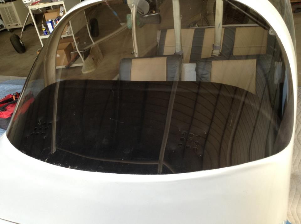

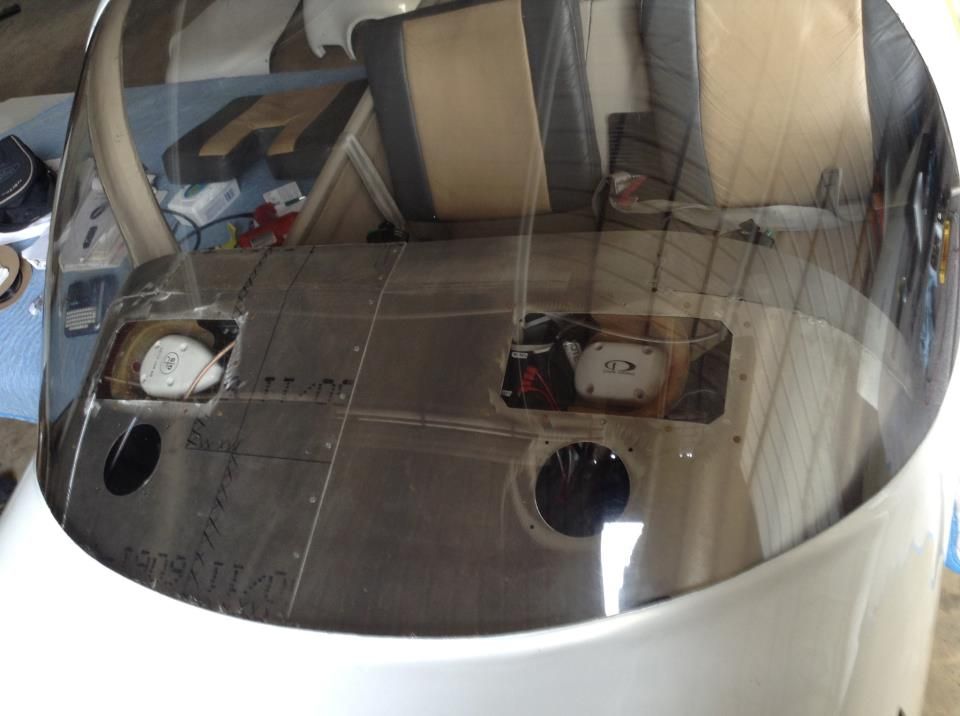

I wired 2 computer fans on the glare shield ducted to the cabin heat box with some SCAT tubing.
I recently placed real fan covers on the glare shield instead of just holes. Makes the installation look more professional.
The fans are controlled via a panel on/off switch.
In winter, with the heat box SCAT tubing connected, they help defrost the windscreen. In the summer, with the cabin heat box SCAT tubing disconnected, they help cool the avionics. They work GREAT.

I'm not flying yet so I don't know for sure how well this works but for most fan installations you want a fan that has a good pressure/flowrate curve. This is especially true if you use any type of ducting. I plan on using two ebm-papst 8312H fans mounted on the F-7106 Forward Top Skin. They work as combination defog/avionics cooling fans. These are 80mm X 32mm fans. They have good flowrate and pressure. Digikey has them in stock for $33.22. Not cheap but these are really nice fans. If you ever need a more powerful fan, the ebm-papst 8212JH4 fan is a 80mm X 39mm fan that has much more flowrate and pressure and will bolt in the same place as the lower power fans. You can find the specs for these fans by doing an online search.
I hope this helps.
