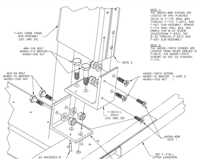

Yesterday I installed the rollbar on my RV-7. I then dismanteled it and saw this:
Obviously there is an edge distance issue here with the hole on the F631A channel.
These are the holes through which the AN 509-10R10 screws are going in (see pic below). The edge distance inside is good as there is another strip of aluminum F631B-L. The The F631A aft channel where the mistake is located is sandwiched between two pieces.
Is that a problem??
Thanks and Merry Christmas to all.
Alain.

Keep building....it is a non issue.

That part is only critical untill you really need it. I'd shoot Vans an email with a few more pics just for peace of mind, (because I wouldn't be comfortable.) See what they say.

I would not worry to much about this - 'When you need it' ... as I see it ... is when you flip over (hopefully never) ... and even so ... the assembly is not going to go anywhere as it is being pushed down into the bracket.
For ultimate peace of mind ... ask Vans and let us know what they have to say ... Good luck with the rest of the build ..

Just did the same thing a few days ago. This is the photo of my proposed fix to send to Vans. Will wait to see their response to you.
Found a piece of scrap aluminum the same thickness as the roll bar, and filed it to fit within the channel. After drilling for 3 rivets, used a round file on the scrap piece to open the bolt holes, deburred, then riveted. I also placed 1 rivet between the bolt holes because the outer section was trying to lift away from the thinner material.

Van's normal response is that they do not approve of any changes including "screw ups" that do not meet the intent of the original design. It is up to the builder or A&P/IA to determined if the condition is safe. Just went through a similar scenario with a friends RV-9A where the fuel tank attach screw holes were dimpled without first drilling to size. All of the holes have slight stress cracks from stretching the metal.

Here is the reply from VANS regarding the mistake I made on my rollbar:
"The final answer on this is the role bar chanels should be replaced so these holes will have some edge distance with the chanels.
Sterling
So I will order some new parts and re-do this bit

I would not worry to much about this - 'When you need it' ... as I see it ... is when you flip over (hopefully never) ... and even so ... the assembly is not going to go anywhere as it is being pushed down into the bracket. "snip"
"the assembly is not going to go anywhere as it is being pushed down into the bracket" is generaly true if there is no further forward travel after a flip.
But if there is continuing forward momentum after the flip the roll bar may fold forward. Such an accident happened to a local pilot who crashed his RV9 in Penticton, British Columbia, Canada (due to fuel flow issues) a number of years ago. The forward momentum of his flipped RV9 caused the roll bar on his tipper to collapse forward causing unstated trauma to his neck and head. The poor chap didn't survive. Really tragic.
