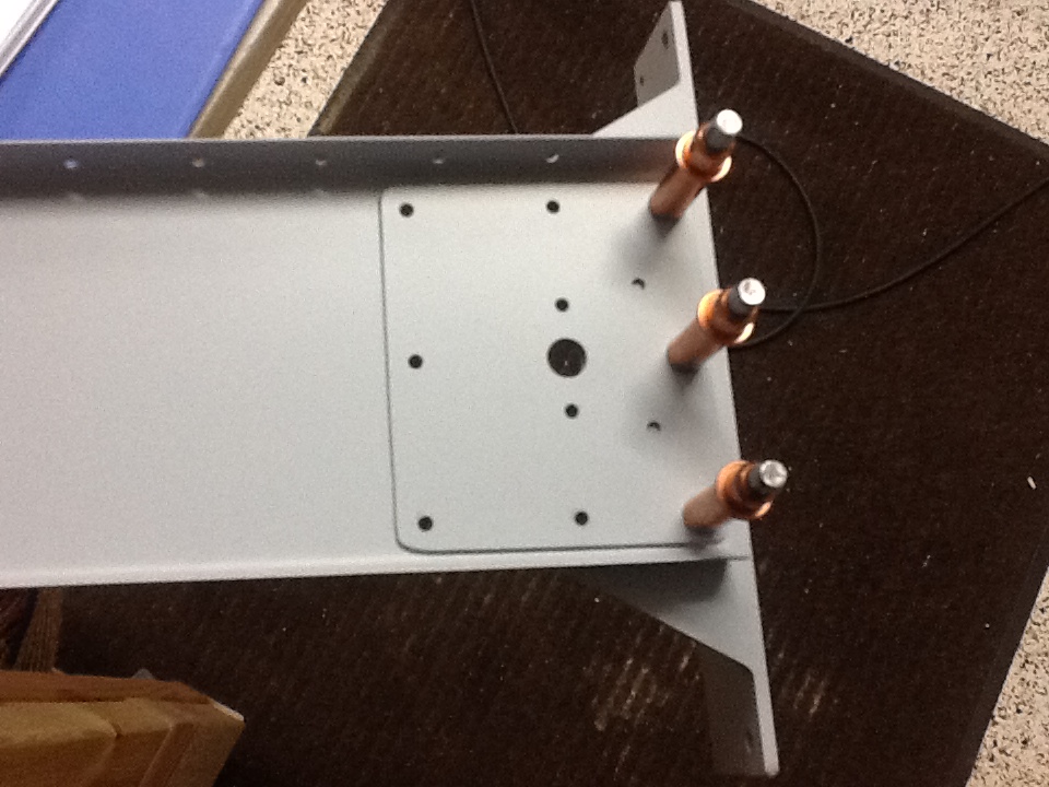

Photo: The R-606PP Reinforcement Plate clico'd between the flanges of R-902 Rudder Spar, and with the R-405PD Rudder Horn behind them. Notice the two undrilled holes in the Spar. Those two holes were factory drilled.

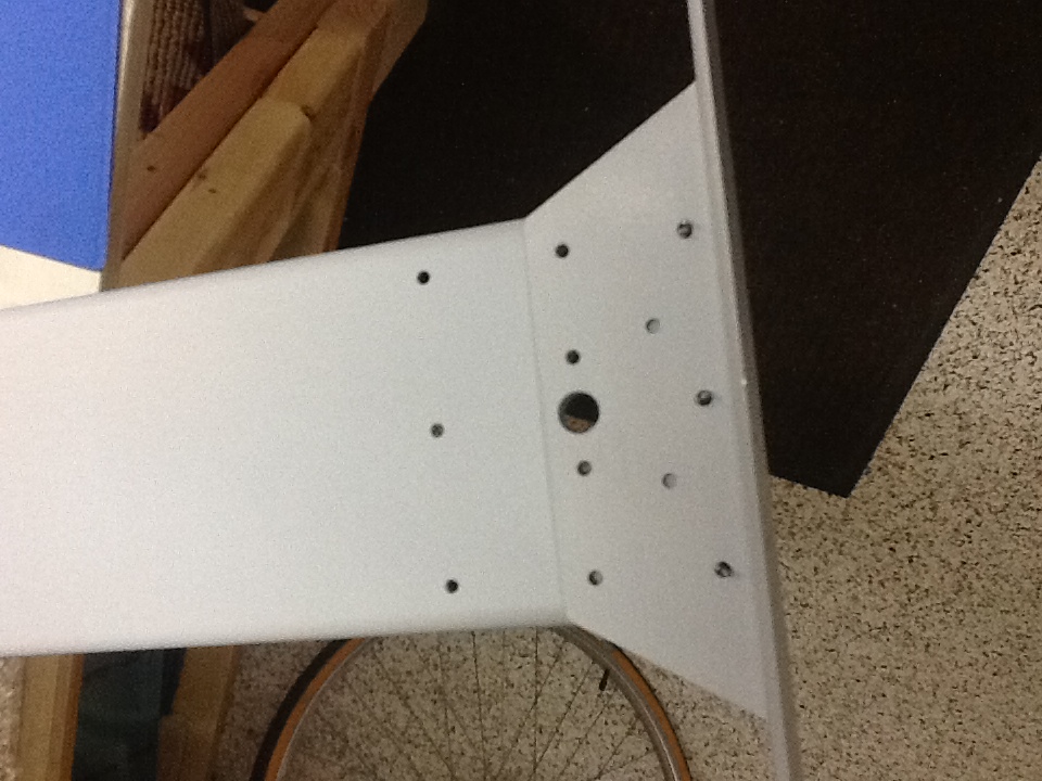

Photo: Same three parts shown from the Rudder Horn side. Note again two factory drilled holes in the Rudder Horn are undrilled in the Spar.
My natural assumption would be that these holes should be match drilled in the Spar to either the Reinforcement Plate or the Rudder Horn before riveting. However:
1) These two holes do not appear anywhere that we could find on Rudder DWG 7, Revision 5. Drawings of the three aforementioned parts and the builder fabricated R-917 Shim that fits between the Spar and Rudder Horn do not show these two holes.
2) The written instructions for Rudder construction do nowhere mention the two holes. The three clico'd holes next to them are specificalled out for match drilling to the spar.
With the holes not shown on the drawings and not mentioned in the instructions, while three holes next to them are, I became confused and telephonedf Vans for clarification. I was told the two holes are "most likely tooling holes" and not to drill them.
Is this a potential gotcha? What did you do?

Those holes are not on my rudder parts or plans. I assume they are for another m9del and suggest leaving them. When in doubt, ask Vans.

Do the holes in question line up in the reinforcement plate, and the rudder horn if you remove them from the spar??
Have you looked farther ahead in the plans to see if these are addressed later--------or if there is something that is going to be in the area that would interfere if there were rivets there?

I matched drilled the spar for those holes and added rivets, but I also made a new larger shim that included the two extra holes.

Same extra holes on the recent 8 rudder parts...no reference in plans. Plans have you create a shim for one set, not both. I just made the shim wider as well and riveted all. I looked at my current flying 8 and the extras are not there. Change must have been made some time this year.

Mine's a 9A, and it has the extra holes as pictured. I elected to match-drill and rivet these holes and the shim. Van's is the final word of course, but there's plenty of material there, no interference issues and the rivets are widely spaced.

Just looked up those P/N on the RV-14 plans and sure enough we have them. The extra holes are all used in this model. Same part used in different airframes.
