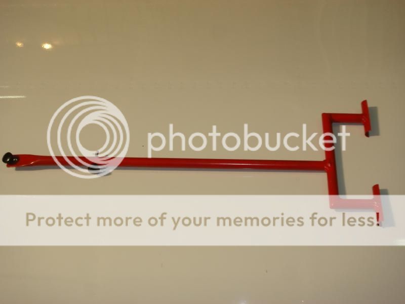

I like to fabricate and have the equipment so I went ahead and made my own gust lock out of light weight 4130. This works whether the wires are inside or outside the control stick.
The threaded knobs are 8/32. I cut a relief in the threads on a lathe in the proper location and installed retainer clips to keep them in place at all times. The end that attaches to the seat pedestal is slotted 1/2" for the screw to pivot during installation. It also allows the gust lock to be extended and tightened up.
I installed an 8/32 plate nut under the seat pedestal. There is a 5/16" steel insert that is drilled and tapped 8/32 in the control stick TIG welded in. I used a small leather hole punch to make a clean hole in the control stick cover and used a dab of contact cement on the inside of the cover holding the hole location in place. There is also a metal anti crush insert in the gust lock at that location.

Nice, real nice! Awesome job. Can you post close up pictures of your attachment to the control stick? I cannot see how you were able to drill without tearing up your wires.

Thank you. The control stick was removed from the plane and I also removed the Tosten grip and the associated wires. Both the control stick and the gust lock were drilled on a drill press for the inserts to ensure they were square to each other, and for welding. I used 9 pin Sub-D connectors for the wiring under the seats. It was not too difficult extracting extracting the pinned wires from the connectors. That allowed me to pull the the wires from the stick. It was a little harder to get them past the insert for reassembly but they made it. Where the stick and gust lock meet, I left about 1/32" protruding so they had a squared off mating surface.

Considering the cover/boot-------why not just run the wires on the outside of the stick??
Much simpler.

That is very true Mike. My stick covers were an afterthought so I originally ran the wires inside the sticks. I still did not like the looks of the bare stick control's so I got some interior matching vinyl material from JoAnn Fabrics and sewed up the sock covers and decided to keep the wires inside. I waited as long as I could for ASA to come out with their RV-10 gust lock but a looming cross country trip with ramp tie down forced me to come up with something quick. Nothing against any other designs out there that work, but they were not for me.

I see one problem - the stick will hit it when it's full back. My stick comes within 1/4 inch of the seat pedestal. You will need that when you try to flare in a full flaps landing.
