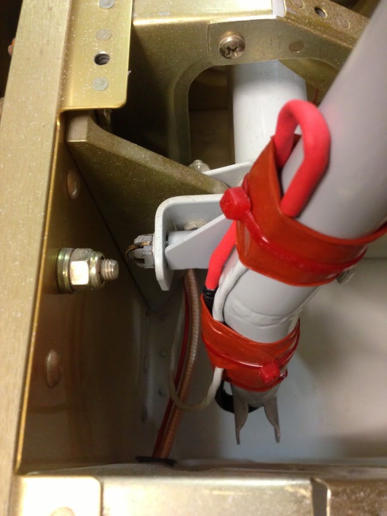

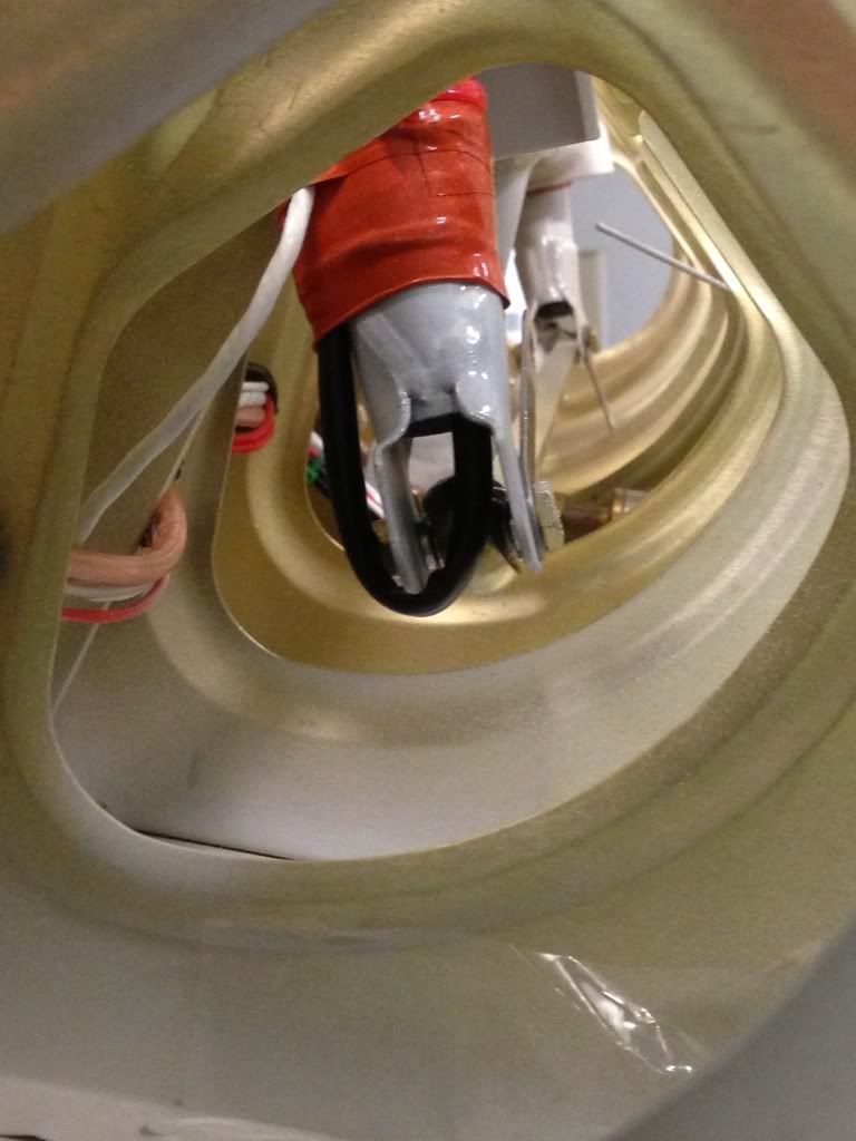

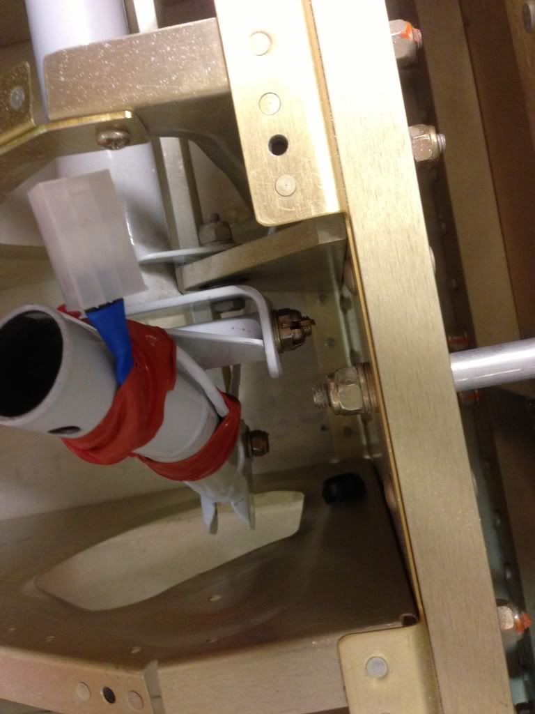

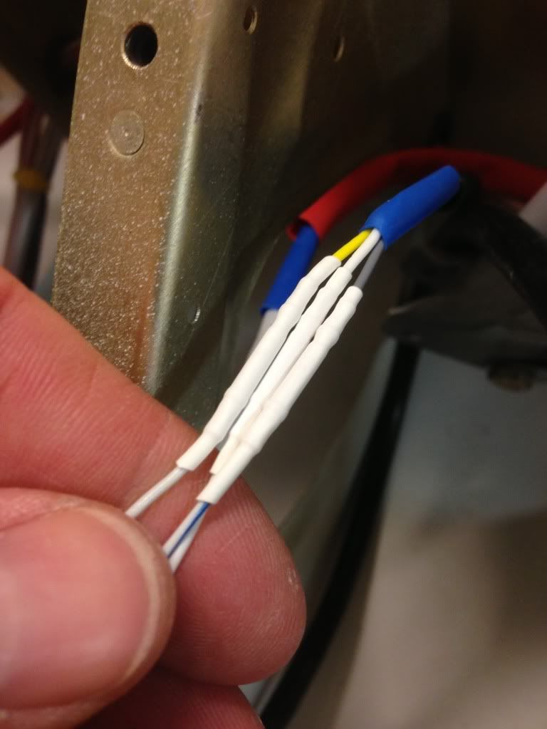

Not sure how different the 7 is from the 8, but I was surprised to see how well it worked running the wires out the bottom of the stick. I used dsub pins in heat shrink as a disconnect point, doubled up the heatshrink and it fit nicely between the 2rod end bearings. I doubled it back onto the lower control stick, wrapped it with silicone tape and secured it to a "node" on the other wiring behind the spar.
Since my copilot stick was removable I did like previous posters and ran the wires out if the stick but under the stick boot
RV 7 400 hours and counting
