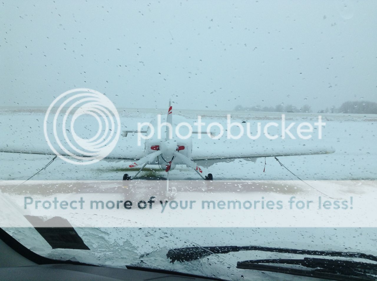

For those of you flying in winter in the North AND have your plane tied down outside all winter long, what is your routine once you get to the airport in order to get flying?
One assumption I am making is that there are no services available at your tiny little airport.
So you arrive one sunny Friday morning. Weekend trip planned. Plane has about 4 inches of snow still on it from last snowfall. Air temps are in the low single digits. Your last flight was maybe 10 days ago or so.
What do you guys do? Haul a portable generator and hair dryers to preheat? Spray on deicer? Battery charger?
