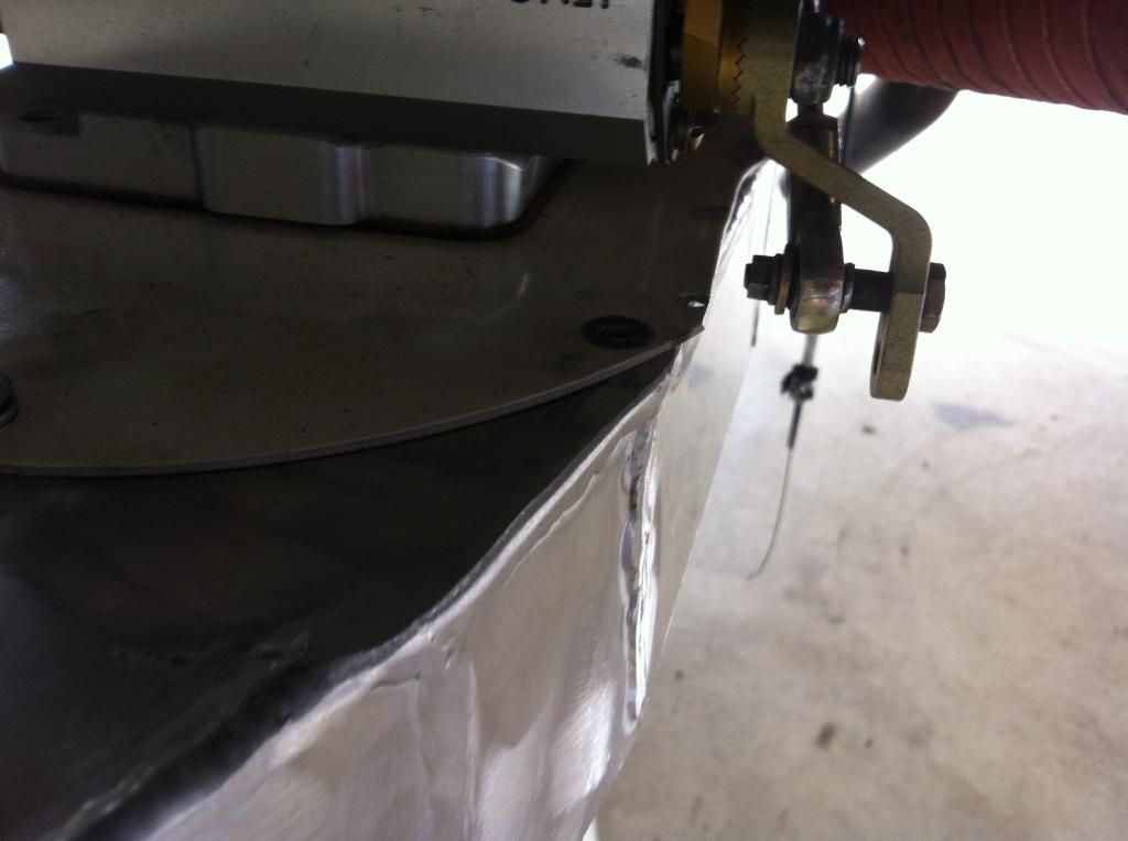

Hey all, Thought I would share an issue I had just a week ago. Cruising along at 4500' and had an engine failure. Put down in a paddock and all ppl walked away.
Upon investigation the rivets holding the alternate air in place had let go and pulled through the fiberglass air box. The FCU air inlet was blocked by the alternate air panel and that's what had caused the failure.
Now fabricating a fully aluminum air box now....
Definitely worth the few $$ and replace your fiberglass box. It should almost be an AD. I know people have made their own and have seem some really nice fiberglass ones on here but 1 engine failure too many for me

Do you have some photos of the box that failed showing how it failed? Also your new design? Also how many hours?

For those interested, the following are pic's of the fabricated box we made a couple of years back.
This in my opinion is a SB needing to happen.

What exactly is it that is wrong with the VANS design?
- OK, it's not the most elegant but it works
- You can't close it in flight but if your main intake is blocked, why do you want to? It's not as if it's something you want to be opening and closing on a regular basis
- as far as I can see, if any bits do come loose, they are going to fall into the cowl, not the engine. Having said that, I can see the pop rivets through he fiberglass are a weak point and I am going to glass over the inside. I also used RTV when I fitted the ring.
In my opinion, the original design was seriously flawed, if you're still running it, you shouldn't!
The failure experienced by dcpearso was from a temporary fix. The original design kept flapping on the initial test flights, I asked the chap that helped me build the aircraft if he had any ideas for a fix. Unfortunately he sealed the flap shut permanently. (non pilot, possibly unaware of the consequenses). I didn't check the fix.
Lesson 1: You as PIC and more importantly the builder MUST check these 'fixes'
I'm not a big 'what if' person. What happens.....happens. But the consequences of this incident could have been disastrous. The incident included a PAN-PAN call that escalated to a MAYDAY. ATC did a great job in support, dcpearso did a remarkable job putting it down with no injury or damage. The aircraft was flown out of the paddock the next day. Testament to the aircraft, there was NO damage!
Lesson 2: Maintenance Authority comes with a massive responsibility, it's a privilege.
