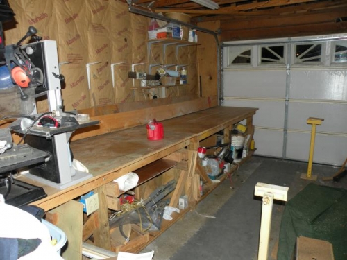

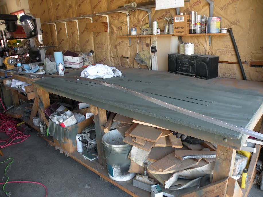

Default Scuffing, Cleaning, Priming Longrons is a PITA!
To cut down on the sheer boredom, I'm scuffing, cleaning, and priming the main longerons in sections. I did the inside faces of the forward half of both longerons in one session, then the inside of the aft half in the next session, etc, etc. As of today, I have the inside faces DONE, and the forward half of the outside faces.
In this photo I've already done the inside of the forward half of the right longeron, and am about to do the aft half. My wife's potting table doubles as my scuffing/cleaning table, and is only about 5 ft long, so I had to tie the longerons to the BBQ to maintain control...
Here, I've scuffed and cleaned the outside faces of the forward half of the left longeron, and am about to shoot primer.
