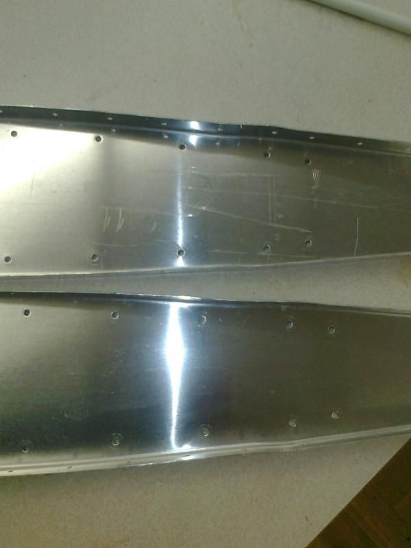

Hey Folks.
I just finished my inventory for my 14A tail Kit.
10 parts came without any blue film and show signs of having been around a bit. By this I mean some have areas that look like they have been roughed up by a Scotchbrite pad, some are dented, and or scratched. The parts E903 from Emp Sub kit 6, pictured below, have dimpling done on 12 holes starting from the trailing edge and some dents in the egdes that you can see in the picture.

I'm building the 10 and I noticed the same thing with that particular part, E903 tip rib assembly for the elevator. I had to flute it anyway so the small dents on the flange didn't bother me too much. All and all it came out just fine even though those parts looked slightly abused when I got them too. Hope that helps. Good luck with your build!!

All of the ribs that came in my emp and wing kits looked like this. I believe the blue film comes off for the shapes to be hydroformed, the surface scuffs and scratches are a result of the forming and or hole punching - a different process to parts that are simply folded and punched. It's quick and easy to sand out the deeper scratches with a fine Roloc sanding disc in an angle die grinder.

There are a few newer rev. level parts (because of development of the RV-14) that get machine dimpled in areas that are difficult for a builder to access with normal dimpling processes (such as the tight area between the flanges on a rib trailing edge like this).
Because the part has holes that are predimpled, it a bit more difficult to remove from the form block after it has been pressed which would explain the slightly wavy flanges.
Scratches are because of no vinyl.
Signs of scotchbright? Don't know, but why not call Van's first instead of starting a thread with a bunch of speculation? (not meaning to be a jerk saying that... just pointing out to the crowd that this sort of thing is just one of many reasons that cause people to get the feeling that tech support at Van's doesn't have a good vibe about the forums)
Oh, and by the way, the area your photos are highlighting where the flange looks like it is not straight... it is supposed to be shaped that way. it is to account for the thickness of the counterbalance arm skin laying under the main rudder skins. It might be evident in the drawings, but if not, it will be when you start fitting the parts together

No idea about the -14 but some of the parts on the -4 and -7 such as wing ribs are heat treated from my understanding. That means no blue film.
I can't say the -7 had parts that were deformed but pretty much every part on the -4 is deformed like you show.
Call Van's but if it were mine I'd just flute it, scotchbrite it, prime it and move on.
