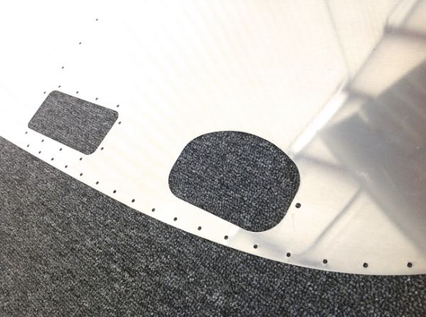

Is there any reason not to cutout the position light wingtip cutout before the wingtip skin is attached?

That's what I did. If there's a reason not to, I didn't discover it.

Why is the nav/position light hole in the bottom wingtip skin so big? All it does is pass three small wires, yes?
Because it was designed to be a retrofitable installation since the lighting kit was initially available for early builders, or in instances where the airplane was initially built without, but added later. As long as the pull string specified in the wing manual was installed and tied off where specified, during the wing build, the prescribed hole provides enough access for pulling in the required wires.

Okay so it's specifically for a retrofit installation. Good to know, thanks.
What if, as in my case, I'm installing the nav light and wingtip extension as I'm closing out the wing tip bottom skin(s)? Wouldn't a 3/8" hole (or smaller?) and grommet fulfill the purpose?
Would that be considered a deviation from the plans and, if so, would it matter, since the hole (large or small), is covered up by the fiberglass wingtip extension and unlikely to be seen?

Much easier to cut before attachment and no downside.

Yes, of course. But if the bottom wingtip skin (W1204D) isn't riveted on yet, why would you even need the <big> template hole, when a small <easy> 3/8" hole will do?

I had the same question when I was cutting those big holes - it didn't seem to make a lot of sense. However, I was wrong.
When you go to install the ground wire, you need to be able to install the wire and the retaining nut on the inside of the wing tip. You won't be able to install the ground wire per the plans if you don't have the large hole. I'm sure you could figure a way to install the ground wire without the big hole but then the connection would be totally inaccessible.
The large hole was also useful for deburring the holes you drill to mount the fiberglass mount and cleaning out drill shavings.
