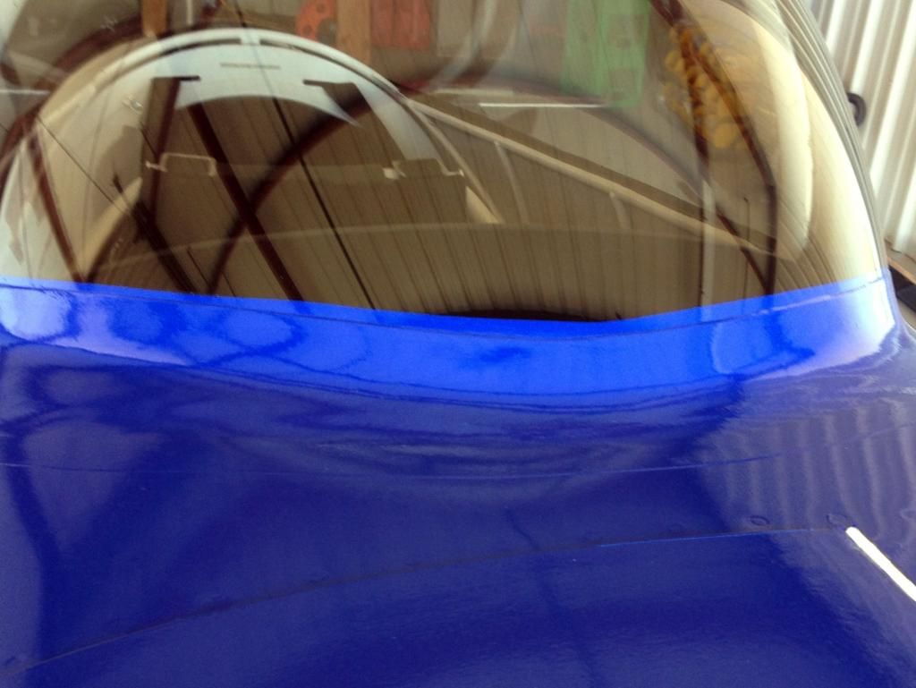

Originally Posted by Rick_A View Post
How did they do the area around top edge of the windshield? Do you have any close-ups of the windshield?
The reason I ask, is that this is one area that my paint needs considerable touch-up and I'm not sure that re-painting will hold up any better.
Rick, I took a couple closeups of the windscreen fairing area for you today. There is an extra layer of vinyl strip added there so that if there's any damage later on (high speed kamikaze bugs, etc.) it will be easy to just peel away the extra strip and replace. It's really hard to see the seam from the extra strip of vinyl, even in the closeup photos. The line that you can easily see is the edge of the fiberglass where it meets the plexiglass underneath the vinyl. The vinyl wrap overlaps the edge of the fiberglass here a bit to give a clean straight line appearance.
I would recommend giving Scott a call over at AircraftWraps (or maybe he'll answer here?) He's can give a more expert answer on how you might use this to address your problem in this area.

Originally Posted by AX-O View Post
Did they remove any control surfaces? Did you take the weight of the aircraft before and after?
The flaps and ailerons were removed. The rudder was disconnected. The elevator range of motion was sufficient to get the wrap on without removal.
The pre-wrap weight was 1,096 lbs. Post wrap is 1,109 lbs. Not all of that weight gain is vinyl though. Last week I replaced my cracked aluminum exit air cooling ramp with a 24 gauge stainless steel ramp that I fabricated. I also added a couple sheets of Damplifier mat to the inside of the ramp space to cut down on floor vibration in the cockpit. I estimate that my cooling ramp modification and repair added 2 pounds (it's thick and bulletproof now!) The rest of the weight, 11 pounds, can be attributed to the new vinyl wrap.

Default Thanks for windshield photos
Interesting the way they do the windshield. I'm sure they get a better bond by having the vinyl extend on to the plexi.
My paint is chipping right along the edge where the fiberglass and plexi meet.
Hi Rick,
We (AircraftWraps) like the clean straight line that vinyl onto plexi displays. We can terminate the vinyl either at the edge or as shown. However, the transition from fiberglass to plexi must be smooth enough to allow the vinyl to transition without have voids behind the vinyl. Gash's windshield transition was perfect.
