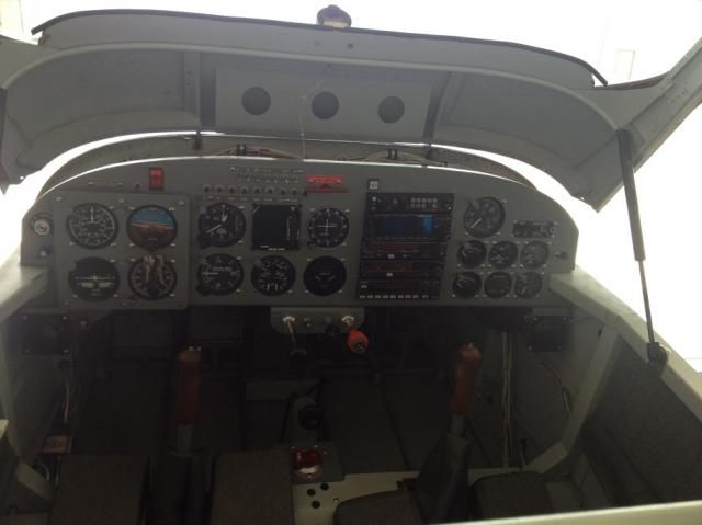

Until this past June and with the purchase of a built RV-6, I hadn't piloted an airplane in almost 15 years!
My plane was completed in ?94 and its avionics and flight instruments have not been upgraded since. That means panel-mount first generation text-based GPS/Comm, Comm2, Nav and Transponder plus the steam gauge six-pack.
To be honest, until I started researching the equipment in the plane prior to purchasing it, I would have said it was well equipped but, I quickly discovered that while I was away, Loran was decommissioned, precision GPS approaches have become common and sophisticated air data computers and flight information systems are common and, to some degree, affordable.
I purchased Foreflight and a Stratus II receiver and was (still am) amazed at the information available to pilots with that and several other similar combinations. I flew a King Air back in the mid ?90s equipped with a Universal UNS-1A and radar. I thought we had big boy gear back then and we did but not by today?s standards.
There are several justifiable reasons to start looking at a cockpit upgrade like ADS-B and the ability to fly precision GPS approaches but I wonder if the cost justifies the results. I wonder if the iPad and other tablets are impacting pilot?s decision to upgrade? It is impacting mine. There are easier stand-alone paths to get ADS-B 2020 compliant and some older (less expensive) but still capable panel-mount solutions for en route and terminal IFR situations that when coupled with the iPad get you very close to EFIS. It is not nearly as clean in the cockpit nor is it as integrated but it seems much less expensive and does offer good redundant capability.
I also want to be careful not to spend a dollar twice. Whatever I do upgrade, I'd like it to be part of the "final" implementation wherever possible.
For everyone who has gone through this expense, trouble and downtime, did you read this and think ?he has no idea what he is missing out on? or did you have similar thoughts and, if so, what do you think now?
For everyone like me on the fence and for the sake of discussion, putting the cost aside, does using a tablet and portable weather/traffic receiver give you the capabilities to make you put off the glass cockpit decision?

I'm biased, but if you are planning to fly IFR, the portable gear and an iPad aren't the way to go. Installing an EFIS and certified GPS will give you significantly enhanced capability.
There is a rathole that you'll have to address. It's how much redundancy is required if you fly in IMC. Paul Dye has written several great articles on defining your mission and how to determine appropriate levels of redundacy.
You may want to take a look at the Dynon and/or AFS prebuilt panels that AFS announced at OSH. It will make the transition go much faster.

One, I have a glass panel. But that's because, in a new installation, it is no more expensive than the 6 pack! (A lot of cost savings in engine instruments; with a $40K engine I wanted to see what was going on in all 6 cylinders). But for an existing plane, you will get very little money back on selling the old instruments. So a retrofit is more expensive, in that sense.
Two, the big one: do you plan to fly IFR? As already mentioned, if the answer is yes, then you need to ask questions about systems redundancy, back up power for an all electric airplane, etc. If enroute IFR, I think you'll find a -6 will require enough concentration that you'd wish you had an autopilot (fatigue issue).
Three. If vfr only, I think an iPad is a fine solution. Put it somewhere where you can see it without looking down too much. But for ifr the information really needs to be right next to the flight instruments or you won't use it.
Four: Certified gps? Really great, but really expensive. How often do you shoot approaches where only a certified gps will get you in? For myself, it was a requirement, because our home field has an "ADF required" ILS approach (the 420W can legally sub for the ADF). But if I could have bought an ADF for $500 I might have reconsidered my choice!
My suggestion: if vfr only, keep what you have, plus an ADSB box and an iPad. If you want ifr,then there's some serious design work (and serious money) to think about. The other issue is if you want more modern (and greatly enhanced) engine instrumentation.

You'd have to define your primary mission:
Day VFR fun
VFR serious traveling
Enroute IFR
Full IFR
With these considerations comes your pocketbook next.
Just my opinion, day VFR, your head should be outside enjoying the view and looking for traffic- don't assume the glass is going to warn you of other traffic. I've had 2 near misses with knuckleheads at the wrong altitudes, obviously with their transponders off and probably with their heads down watching the "video show"...
Portable GPS with weather gives you great capability for VFR with your old panel for minimal cost.
For serious IFR, glass is the way to go only if you know how to work it properly and I stress that last part. Read the manuals, understand everything thoroughly and be prepared to get some training with it. The intuitive, situational awareness it can offer is tremendous. It can be equally dangerous if you don't know how to work it properly and are fumbling around in actual IMC.

Thanks for some great comments and advice. I fully agree that “defining the mission” is the place to start and the standard by which smart equipment purchases should be measured. It wouldn’t be very difficult to over invest in avionics resulting in a plane that is worth more to me than it would be to the market.
The other side of that thought for me, using Keith’s analogy about restoring old cars being something you like to do; I do like that kind of project.
I also know myself well enough to know that I see planes/racecars/motorcycles/houses/etc. for what they could be rather than what they are. Over the years that has cost me a lot of money though it has been fun—most of the time.
The primary mission of this plane is for enjoying VFR flying over relatively short durations (<2 hour flights) on VFR days. That doesn’t always work out and it would be beneficial to have modest IFR capabilities—which the plane does have now in the form or ILS gear.
I highly suspect that I am in good company and most/all of you like the mental distraction from work/everyday life of contemplating your next project/adventure/achievement.
For now I am happy to fly the plane around as it is taking wife and children for rides in the hopes that one of the children will get interested in the amazing world of aviation like I did at their age (I am an older dad). I enjoy aviation a lot too. I had forgotten how enjoyable it is to fly, and, at times, lose yourself in the mental demands of safe flight.
This stuff is for fun and also fun to think about the potential.
I still have a question though: Has the tablet + aviation software like Foreflight + portable ADS-B receivers given us VFR steam gauge pilots a viable extension of time before upgrading is all but mandatory?
Just in case you no longer remember what a panel full of stuff looks like, here is my example:
