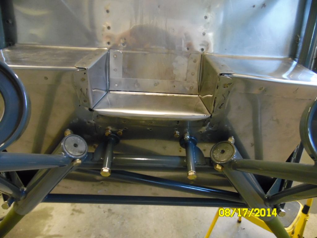

A f/p rv4 may also require modifying the firewall with a firewall recess kit to allow room for the governor.
