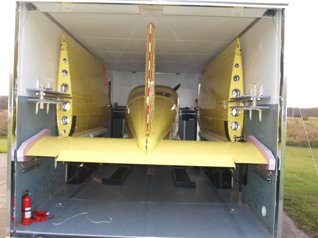

Has anyone found an enclosed trailer with a 98" wide rear opening besides David K? I've asked around at several trailer dealers with no success. I asked a Wells Cargo dealer about a special order and they refused because the said it couldn't be done without compromising the structural integrity of the trailer.
They are right there is no 98 inch wide trailer on the market unless they are custom made. However there are a few RV12 owners who are using a 96 inch trailer to tow their 12s with. See the links.
The Shadow Gt made by Pace American:
http://www.paceamerican.com/search?s...ords=shadow+gt
At this link you can see pictures of the 12 loaded into the trailer, note the rear picture of the foam around the horizontal stab:
http://s1286.photobucket.com/user/he...?sort=6&page=1

Our trailer is a Pace America Shadow GT and it is sold with a standard rear door opening of 96". We custom ordered ours with a 98" opening. The foam around the horizontal stabilator is for protection only, during loading and unloading. It does not touch the walls.

Our tow vehicle is a 2011 Ford F150 with an EcoBoost engine. We have trailered our RV-12 over 4,000 miles with this rig without any problems. It has traveled twice from Ohio to Florida and back plus other stops. No damage whatsoever. The trailer was approximately $10,500 with several structural enhancements. See pictures for details. Feel free to email me at hemlockfield@windstream.net.

Yes, great job indeed. Roger was kind enough to provide a description of his trailer, as well as a few photos, and permission to post them for the benefit of the RV-12 community.
The trailer I built is to Australian (NSW) standards. The design was built to a maximum weight of 750 kg so as to avoid installing brakes. The trailer was then built of aluminium. The overall width was 2.5m.The main wheels were lower by 250mm than the nose wheel so to lower the tail so the overall height was no more than 2.4m. Towing tail first was done to minimize the tongue weight for my light tow vehicle. I used a trailer winch to pull the plane on to the trailer. I put a rigid tie down at the tail. I secured the rudder and the elevators. The wings were fitted on the side doors which let down and had props as seen in the photo.
