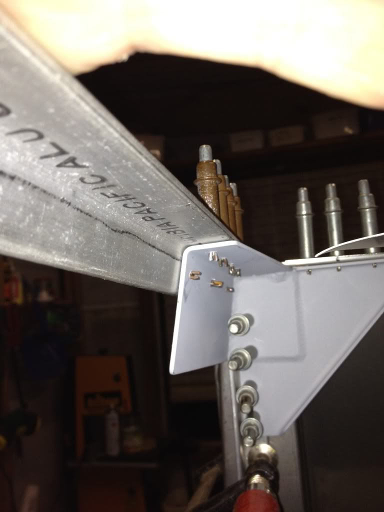

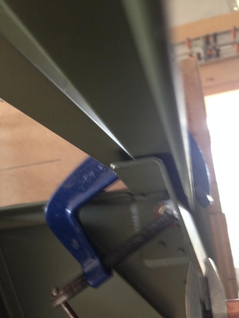

This (not very good) photo shows there gap between the lower forward longeron and the weldment. There is about a 1/4 inch gap unless I clamp it, which then induces a bit of a curve in the longeron - I have the same problem altho' to a lesser degree with the top weldments.
Longeron is running from the top of the photo to th e mount. The clamp is loose. There is an extra bit of angle on th eleft which is jigging the firewall and F-404.
I'm wondering if I should split the weldments to make two ears which would then more easily conform to the required angles.....?? I think this is the arrangement on the RV-3
Both sides are the same and I have (again) rechecked all measurements and angles. The problem is with horizontal alignment - vertical seems more or less OK.
Sorry about the quality of the photo.
Chris

I cut the weldment, corrected the angle and then welded it back together.

Thanks - where abouts on the weldment did you cut?
Its a shame that Vans makes the weldments straight (per the drawings) - when casual inspection of the plans and some simple maths indicates that they really ought to be made with some angulation both laterally and vertically - around 2 degrees up and out would fix it!
Is cutting and rewelding a common fix or do most folk just clamp up and build on?

Default Cut, adjust and weld along the red lines
It worked for me....

I also like what Derek did on his, good job Derek! Either Derek?s method or what I did, cutting along the bend and tweaking I?m sure would be fine.

My worry about cutting and rewelding - as I understand how you guys have done it and how the weldment is built in the first place - is that now you will have a welded joint in tension rather than in shear. Isn't that structurally less sound?
Right now I am contemplating cutting off the ear, grinding out the original joint and repositioning the ear, to get the joint back in shear. I know nothing about material strength etc so perhaps its not necessary but this is not a joint to have fail! Actually, if I decide to go this route I might bend up an new ear and incorporate the gusset. But I'm guessing that 4130 steel will be a bear to bend, never mind to bend accurately?
An alternative I guess would be to make a small wedge from 6160 aluminum to fill the 1/8 gap Not wild about that.
Moreover, I am still interested to know how many RV-4 builders have this problem and what most folk to to resolve it...?

I very, very, carefully and patiently......
1. Ground down the welds and separated the weldment into 2 parts, all the while being extremely careful to not grind or cut into the weldment itself.
2. I then adjusted the weldment angles to suit my aircraft.
3. I then re-assembled the weldment as per the original design, then welded the weldment back together, welding in the exact same location as when originally made.
After all this I believe that the structural integrity of the part has not been compromised.
