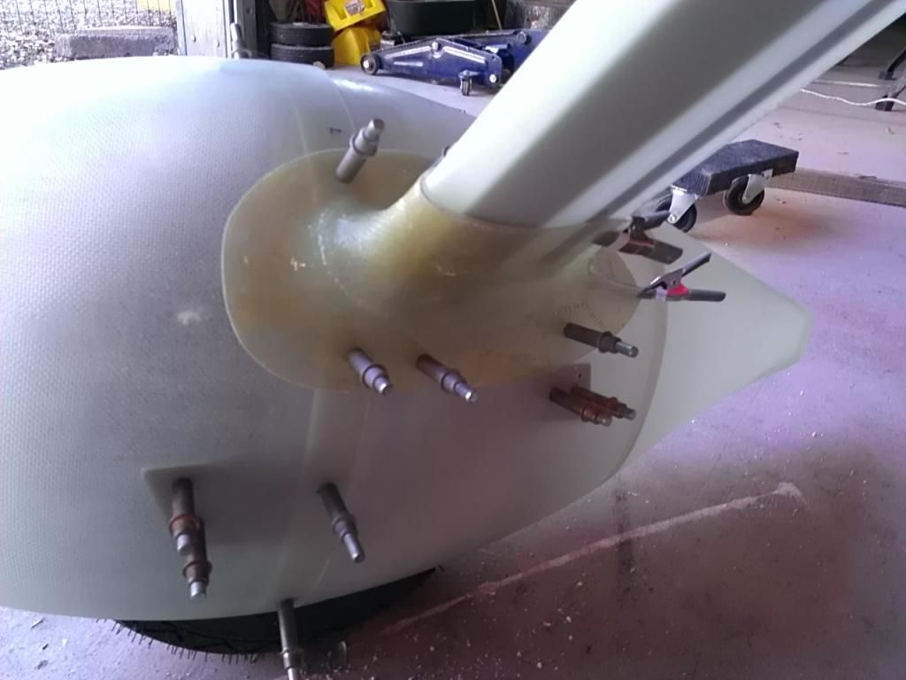

'Lest you guys think I'm smoking something here is a picture of me pushing in on the forward section. That is about a 1/2" indentation.
Working on the lower intersection fairings. I'm tempted to leave them in 1 piece and screw them to the pants. Similar to how the uppers work. I've only seen 1 ship done this way. Anyone with any experience with this idea?

So that front glass is not right. Mine is just as solid as the rear part. I think you got a bum part for sure.
As to the bolt on fairings, I was thinking about doing the same thing. Here's the ones I did on my RV9A and they worked just fine that way.
I used 3 #6 screws to hold them on.

Thanks for the pictures Andy. I think I'm going that way.

I used RV-bits gear intersection fairings from South Africa. They are a bit larger than the home made ones depicted above, but they fit right on.
The upper intersect fairings were especially great considering the complex shape. My only problem was that I had a small pucker in my left wing root fairing, which holds out the RV-bits upper intersect fairing. When I get that laying flush, all will be well.

I ordered the wheel pants around a year ago. I just checked - I can't dent the forward part of the wheel pants. My guess is, that there is something wrong with your front wheel pants (i.e not properly cured) - you might want to contact Vans.
