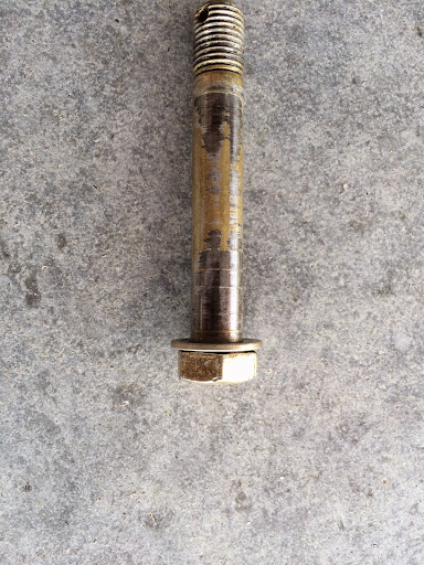

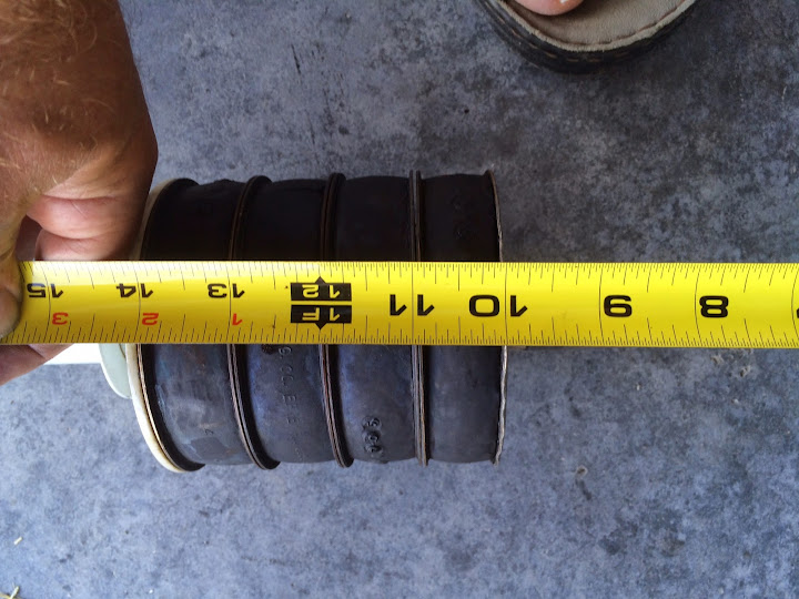

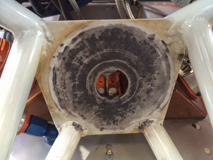

It was time for my 50 hour oil change, so I took this opportunity to inspect the Nose Gear on my RV-10. My RV-10 now has 1140 hours on the Hobbs, about 5% of my landings are on grass runways, some even have rolling mounds like in Port Elgin, Canada (CNL4). I always keep the nose off the ground until full aft elevator won't allow it.
I was glad to see and report that mine doesn't have any cracks in the mount where the donuts rest up against it. However I did see the bolt that goes between the donut shaft and the nose gear legs had signs of wearing. Also the two bolts that hold the gear leg to the mount in two places were also showing signs of wear. I'm going to go ahead and replace these bolts while I'm at it.

That looks pretty good. More like you'd expect, don't you think?

Ray, You have similar hours and I agree we have some wear in the bolts and bushes, again most likely accelerated due to the rough surface issues. We are replacing them all.
I think the high frequency hammering the elastomer plate cops on an uneven surface is considerable compared to a bitumen runway.
It will be interesting to watch over the next 1000 hours how this develops. It will be an annual inspection item from here on.
