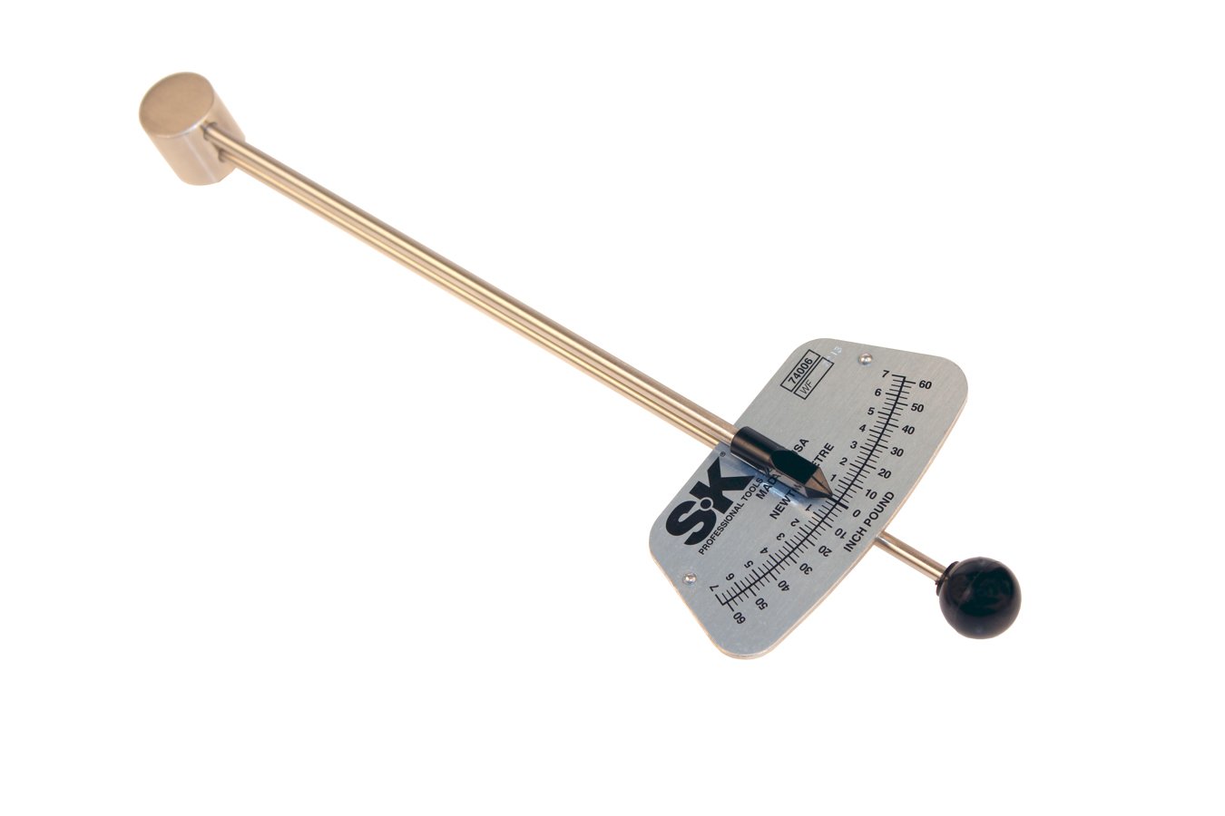

I am installing the inboard hinge bracket on the HS spar and am not able to determine the "friction drag" of the nut. I need to add this value to the recommended 20-25 inch pounds for the nut itself. The torque wrench I am using does not go below 20 inch pounds so I am not able to measure a torque as low as this. Any recommendations?
AN3-5A Bolt
AN365-1032 Nut
Thanks in advance for your time?.

I tested the friction of an AN 365-1032 nylock nut onto an AN3 bolt with a normal wrench and a small " fish scale". The length of the wrench was 5 inch and to rotate the nut the fish scale read 0.2 of a pound . If you do the math this translate to 1 inch pound torque just to turn the nut. And yes this was a new nut and bolt, I do believe the metal lock nuts do have a higher torque value just to turn the nut compared to a AN 365 nylock nut. IIRC there is a value for metal lock nuts in the new section 5 of the build manual. My advice would be to torque to 25 inch pounds and be happy.
Hope this helps
Arie

You can get one of these to measure it:
http://www.amazon.com/gp/product/B00004SQ3B
In my experience, the drag is about 4 in-lbs. Before I had the wrench above, I just set my torque wrench to 25 in-lbs and called it good.

Something like this does a great job measuring those.
SK Hand Tool 74006 1/4-Inch Drive at Amazon.
