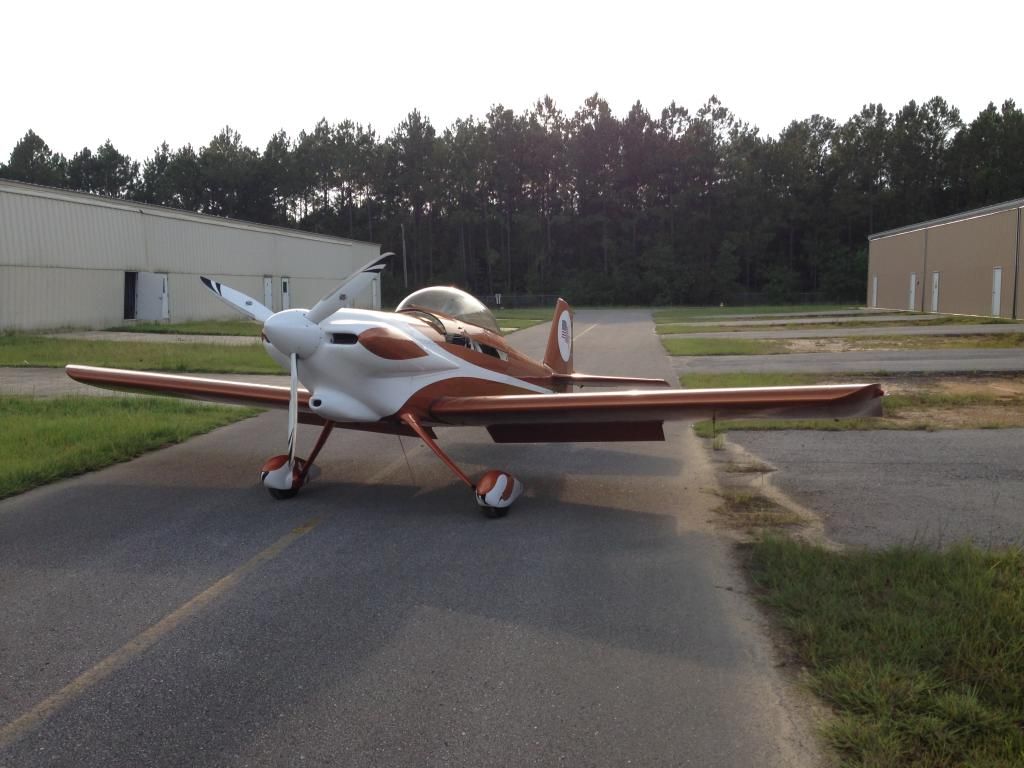

I recently, 1.5hrs ago, replaced my A/D 2 blade with a Catto 3 blade. I have been totally impressed. The pull on the runway is better, top end better, and when I pull the throttle to slow it down, the Catto seems to deaccelerate faster.
I am sold....
I have not been able to get real world numbers yet, maybe this weekend if the weather holds.
Phil
[IMG][/IMG]
I am sold....
Phil
[IMG][/IMG]
Wow, N621RT sure looks good with that 3-blade prop on it. I bet Tim will wish he never sold it after he sees this pic.
