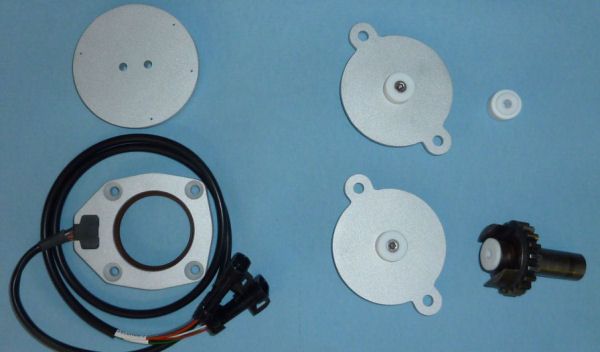

Posts: 286
Default EFII on GTSIO
Here is a pic of some of the other parts involved to set up the GTSIO.
On the left is the crank trigger and trigger wheel. These go on the front of the crankshaft which is accessible under a cover plate under the propshaft.
On the right are the magneto block plates. These have Teflon bushings that locate the accessory drive gear and shaft which remain after the mag is removed.
Robert
