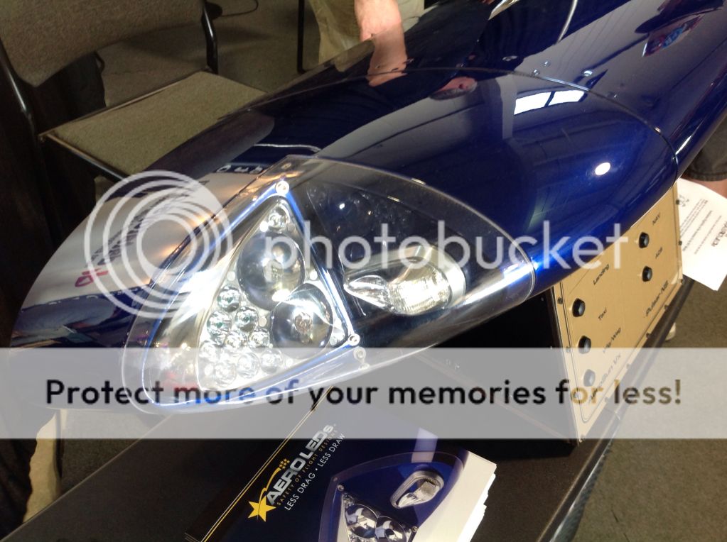

Here is a pic of the AeroLeds that were on display at OSH. That's a NAV light with stobe in front of tha landing lights. I really think this is going to replace all in wing landing lights one day. They are lighter and use less power.
The new AeroLEDs are probably my favorite of available options, but I'd really like to see someone demo what the light coverage in front of an actual aircraft is. On the one hand, they appear to sit further forward than the standard tip lights, but on the other hand, a lot more of the lighting comes from further into the lighting recess. Thus I figure they're probably a wash vs. the standard tip lights in terms of coverage, but I'd love to see a demo showing otherwise.
The Aveo ziptips really look like the coolest option, if they ever make it to production...but with the delays continuing without apparent end, I don't have a lot of hope that they'll have a real product out any time soon. Plus it sounds like they'll be expensive with a capital E.
So basically, my standpoint on current options goes kind of like this:
  • Leading edge lights I know will provide good lighting and good coverage, plus I can exercise lots of control over what lights I use.
  • Aveo tip lights look as if they solve the coverage problem by not even using the stock light coves, but who knows when they'll actually have a product.
  • AeroLEDs look cool, but I'm skeptical that they won't have the same old coverage issue as other tip lights.
So I end up basically sitting between going ahead and cutting the LE holes now, before everything goes together permanently, or skipping the LE holes for now and hoping for Aveo to get their act together. The downside of the second option is that if Aveo doesn't get their act together, I have to cut LE holes on an assembled wing. Not a huge inconvenience, but one I'd prefer to avoid.
Most likely I'll end up holding off on the cuts until I'm about ready to rivet the LE sections, and absent any sign from Aveo at that time, I'll be sending Duckworks my money.
