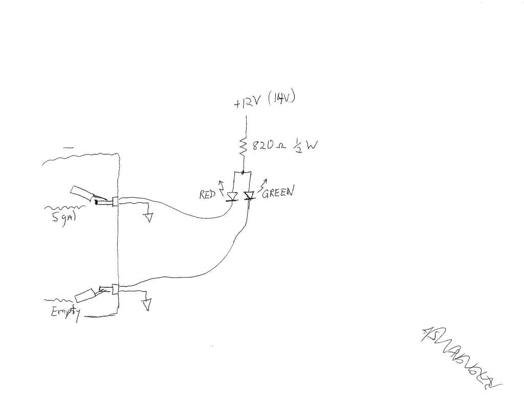

If you want to use 2 switches and 1 LED (BiColor) you're going to need some CMOS logic or at least some DPDT relays. If the float switches were DPDT you'd have a chance but they aren't, SPST. If you want to switch an LED on/off with a SPST you'll need logic.

Originally Posted by Toobuilder View Post
Yes, by "floating", I meant that literally - probably a poor description. anyway, it is in regards to the fuel level. I didn't define open or closed because I'm not sure what the circut needs. With these switches I think I can configure them to open or close when high and dry or submerged.
Right, by orienting the switch float one way or the other you can make it close when "fuller" or "emptier" than the mounting location. (as long as Mr. Gravity is pointing the right way!)

This is what I was talking about. No CMOS or relays or other stuff should be needed. Common anode RGB LED, leave the blue disconnected.

Great!
...Even I get it. Time to buy some LED's and switches and breadboard this thing.
Thanks much!

Originally Posted by fl-mike View Post
This is what I was talking about...
Hey Mike- I purchased the LEDs and float switches and have been playing with them on the bench. I have the common anode tied to a 1k ohm resistor (not the 850 ohm you specified, but that's all I had on hand), and a dead Odyssey battery (10.5 v). I can get the red segment to light, but not the green or blue. I understand that red is the lowest power of all the LED colors... Is the higher value resistor and dead battery dragging the voltage down so far that blue or green don't light off?

I probably should have specified two different resistor values in the cathode legs to optimize the current in each LED to 20mA. Rev A!
I'm surprised you are not seeing anything on the green, but green and blue do have a higher forward voltage than the red. Parallel two 1k resistors and try again. That should be safe for a 10V supply. Let's try and get light, then you can finalize the values.

I would add a 5.1v Zener diode in parallel with the LED's to ground to help regulate the voltage seen by the LED's.

LEDs operate on current. Change the current and you will change the luminace. You need two resistors one for each led. The resistor is selected by first picking the desired current. 20mA is a good starting point. Different LEDs have different operating currents. The resistor is determined by (Vbatt - VLED)/20mA. VLED is based on the forward voltage of the LED. No Zener is required for this type of circuit. Look at the datasheet for your LEDs to get the actual values for VLED and the current

A Zener is not required but will keep the brightness at a more constant level.
