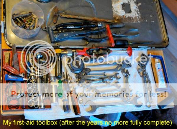

This first aid toolbox was carried by a Piper Cub driver who made it from CONUS to Dutch Harbor and back.
