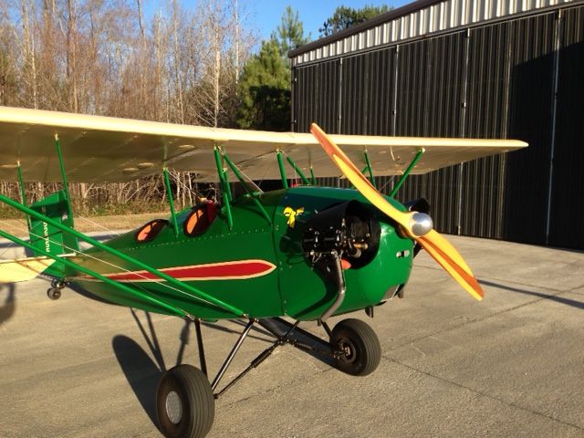

Go in with a partner on something like this:
Relatively inexpensive and tons of fun.

Old 08-06-2014, 02:28 PM
wera710's Avatar
wera710 wera710 is offline
Join Date: May 2008
Location: Pottstown PA
Posts: 209
oh man, is that for sale? I am in LUST!
