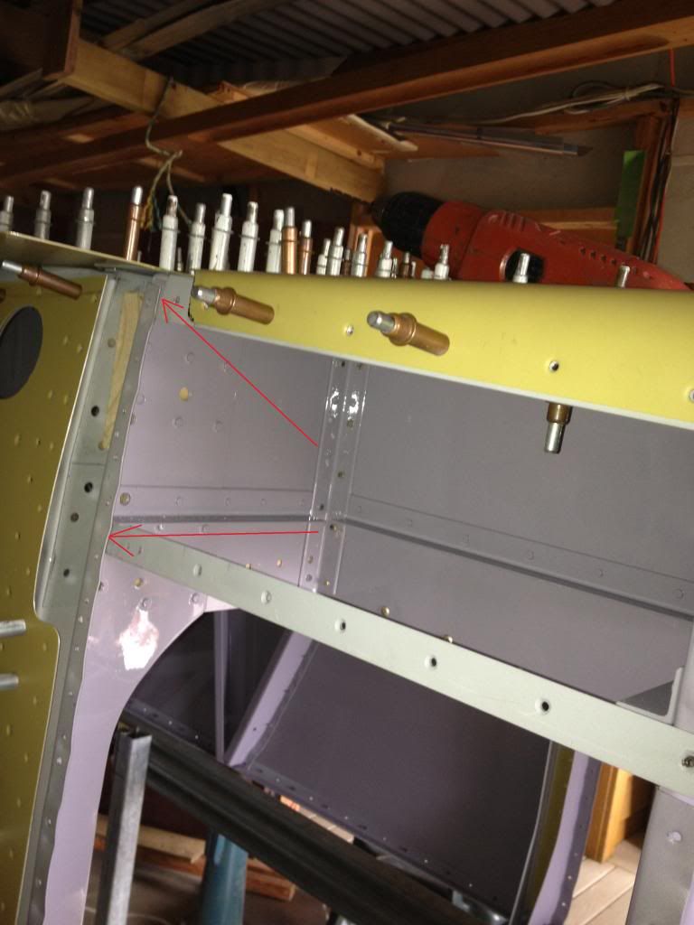

I'm struggling here to get this area of the fuselage sorted. The seat ribs don't insert cleanly into the recesses on the bulkheads and need a bit of cutting, filing. That's OK, I have learned not to do anything without a lot of thought. My problem is that I cannot see a detail on how to make the joints around the bits of angle that run across the F-404 (spar box). Should I cut them away, joggle them or what?
Also any thoughts on how to put this area together accurately will be much appreciated!

Hi,
If your question relates to how the 2 pieces of angle intersect the spar box former ( apologies I dont have my plans handy, so I cant quote part No's) here's what i did. The 2 red arrows indicate where i notched the angle to accomodate the thickness of the former. Hope this helps, if not let me know and I may have another picture.

Thanks - I don't have a page 8-35. The section stops at page 8-12??!! I've read and reread the whole of section 8 and can't see anything relevant!
I understand about riveting the ends of floor and seat webs to the angles on F404.
