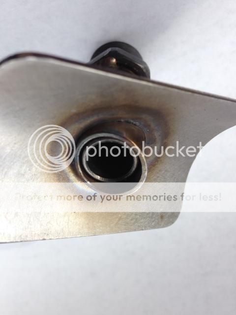

Originally Posted by PerfTech View Post
...The photos below are of our double walled saddle mount that is currently being tested. This should eliminate this heat transfer completely. The inner tube that carries the blow-by products is welded only at the cooler top fitting and has .025" clearance all around. This insulates it from the hotter outer tube that is perpetuating the buildup or coking.
It also seems that any major hard buildup is on systems that the exhaust valve mounting tube was welded into the exhaust pipes and not on the saddle mounts. We are and have been working and testing many different designed parts to eliminate the possibility of this happening and have several in use now, building time. We will report the results when they have accumulated viable, credible information at 20, 40, 60, etc hours and when available. Thanks, Allan
Allan posted the above just before OSH, so it's time to start hearing field reports (coking or no coking) about the double wall tap.
I welded one into my homebrew tap 10~15 hours ago. Had the cowl off last weekend for an oil change and could detect nothing in the tube but a film of the same gray/beige dry deposit seen in the tailpipe. More reporting as the hobbs rolls forward.
