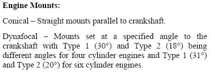

The fuel pump over flow fitting is usually what would rub on -4's unless the firewall is pinged/dented in a bit to clear it and/or the installation of the vans fitting they make and sell. This was the case on mine with a conical mount and the same when I switched to the dynafocal mount.The heater box was probably placed where it is when the engine was mounted with those spacers and may have cleared then but when you correct the spacer. Issue you will most likely need to relocate it. It's very tight in there as you know. I used The Lord dampeners too and they call out for a washer (for eventual sag) on the lower to donuts only. No spacers. I'd put money on having miss matched mount to motor as mentioned.
Your -e2g appears to be a Type 1 dynafocal mount from what I read on Wikipedia
Type 1 (30°) dynafocal mount attachment and Type 2 (18°) mount attachment (angle to crank)
