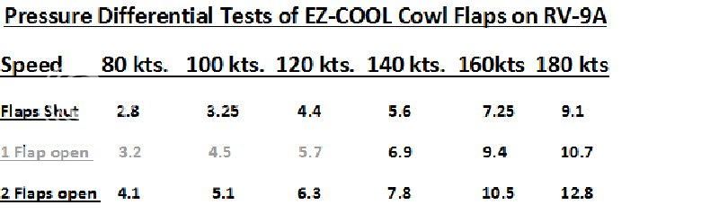

While it may appear like I am on a fast track to test flight, I still have many things to do while the cowl is off to prepare for Osh. so it may be a few days before the results are in.
I also need to clean the belly of the plane, the flaps and a few other things before the show.
Tonight I finished up the cowling part of the install. Next is to add the switch and wires to the panel.
I decided to forgo the model airplane servo type wiring and connectors and splice in some real Tefzel airplane grade wire. Just from limited testing I am not sure it would be wise to try and run two of these things off of one of those tiny extension leads/connectors. I don't like redoing stuff so I did not want to take a chance and decided to roll my own wiring.
Did that and then reflective taped them to the cowl up and around to the top left corner where I will install a connector.
Not sure if it will help or not but I also applied some reflective tape to the actuator body where possible.
Tested everything up to this point and was trying to see how much power these things had and almost mashed the tip of my middle finger off. Beware these things are strong!

Brian I was just wondering, the reason you went with two cowl flaps. Could that be overkill for any reason. Maybe a chance of a little shock cooling ? Two sure look better and make for a balanced appearance.
Can't wait to see them at OSh. Your going to be the first consumer tester.

I went with 2 partly because I wanted a symmetrical look.
I also figure that 75-80 percent of the benefits most likely will come from adding one and two most likely won't lead to anything bad "BUT"
Allan posted his pressure drop testing table that seems to indicate ~ 45-55% increase in DP (2 vs 1) in the speed zones I am interested in. I am not sure how DP correlates to CHT drop without looking up one of Dan's charts. I am guessing it will improve them but not by enough to be concerned about going too far.
Originally Posted by PerfTech View Post
....Here are the pressure differential numbers we gathered on my airplane (RV-9A). These percentages of increases were typical of what was gathered on all the other tests aircraft with stock Vans factory cowl. We installed a second unit and tested the improvement as many people were ordering two and ask for this differential information.
Bottom line is that I want to be able to use the climb performance of the RV and have been limited by CHT's. Using the redneck engineering theory of if one is good then two must be better!
I know there will be a speed penalty of using two over one but I don't care about that in the climb.
