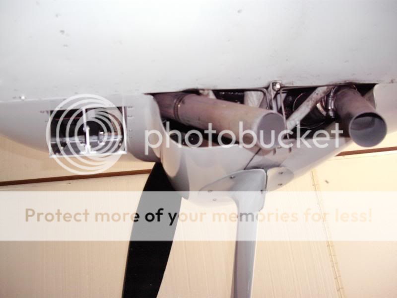

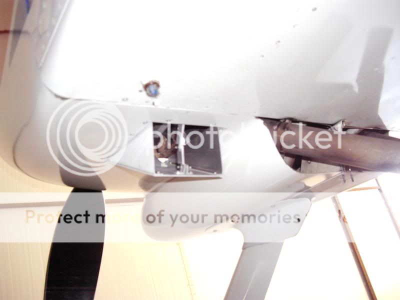

Allan,
Do you have any photos of the inside of you lower cowl with the cowl flap installed? There are a few variations of Vettermen exhausts produced over the years. Also the heat muffs also vary in location. Do you have photos from some of the beta testers installationsl that might show the cowl flap installed on aircaft with the varying exhaust systems
Any images would be helpful.

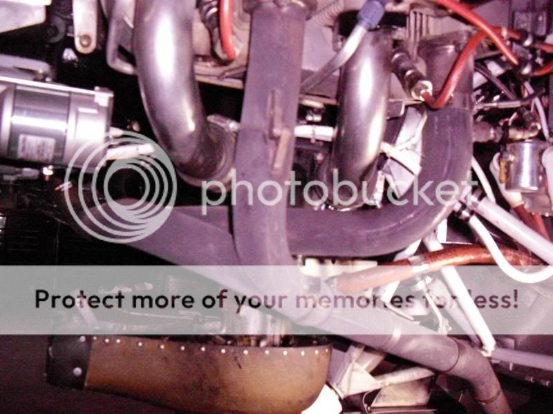

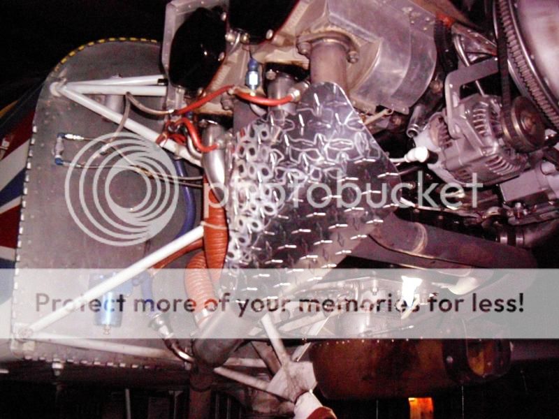

... I am sorry but the photos I have probably are not what you need. I will post a few here and on next cowl removal I will shoot some good ones. This is the exhaust system on my RV-9 and is the most popular one. Also you can see my heat shields that stop the radiated heat from attacking the cowl etc.
Thanks, Allan...
