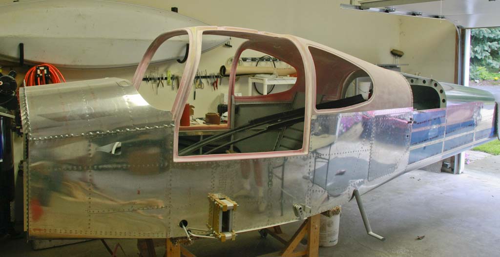

Finally back to making progress, fit the cabin top today. I could not believe how much I had to take of the sides of the door opening.
Congrats! That's how you know you got it right - when you think you've removed ALOT of material. Now it really looks like a plane!

I asked Ken at Vans if you were really supposed to remove that much, as the plans have you do your first cut leaving the whole wall thickness, the curve, and 1/16". By the time I was done I had sanded at least a third of the way through the side of the door frame on the fiberglass. Ken said no one ever asked about that. Given how different the actual is from what the plans describe I wonder about his answer. Now I am trying to figure out exactly how much flange to leave for the McMaster seals, can anyone point me to good guidance on this?

The "never heard that before" is pretty common at Vans. Not sure if they don't share the information internally or something else, but it comes up a lot.
There are several threads on the McMaster seals and the flanges. Try searching in the RV10 section and you will find them.
